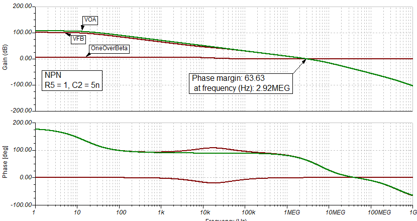

I'm trying to simulate a very standard TL081H based Linear Power Supply Topology in TI-Tina.
I'm modifying the spice files from TIDU026 Single Opamp Slew Limiter - Tim Green.
I've watched a few on-line videos. I've also been looking at the SBOA626 Opamp Stability Theory and Compensation Method by Art kay and Collin Wells. None of these venture outside basic opamp simulation.
My Linear Power Supply simulations are showing waveforms that don't behave as I would expect.
The AOL curve isn't continuous. It flattens at 0dB then a few decades late continues into the -dB area.
1/beta seems to merge with AOL - rather than cross-over it.
Repositioning the Vout and the Voa_U1 tabs gives different results. Possibly I haved used the incorrect locations for spice work.

    From the amplifier's perspective, this circuit has two feedback paths, so checking the stability in simulation is a little different. To break the loop complete Also, I noticed that the Vee voltage wasn't connected to the V- pin of the opamp.
    This document explains how to check the stability of this topology at a high level (on page 5), and I've moved your schematic around a bit to make it easier to analyze. Starting with the PNP version, where I broke the feedback loop at the inverting input of the amplifier (which opens both feedback loops). To include the effects of the input capacitance when the loop is broken at the inverting input, the total input capacitance of the amplifier will need to be added manually before the inductor (which is why I added Cin below):
    At DC, the circuit is behaving normally:
    The loop gain of the circuit with respect to the amplifier is VFB(s) / VM(s), but given that VM is the test signal, LoopGain = VFB.
    Notice the rapid phase shift of 1/Beta around 1MHz, which is not ideal. Adjusting the values of R5 and C2 will change the 1/Beta curve and smooth this out.
    For the NPN version, I broke the loop in the same place:

    From your modifications done to the Sim files, I created four Linear Power Supply simulation circuits.
    Two for Positive Voltage. A Low-Drop-Out version and a “standard” version
    Two for negative Voltage. A Low-Drop-Out version and a “standard” version.
    You made an offer to determine the optimal R & C values for these circuits. I’d appreciate you doing that. Firstly, I’d like to see what sort of combinations are appropriate. Additionally, I’m sure that others would like to see what you do as well.
    Both (non LDO) Regulators appear to have approx 60-degree phase margin and look good.
    On the LDO versions, the phase swing was severe. I added Miller Capacitance across the PASS transistor which smoothed out the phase considerably.

  • Hi Peter,
    An update on our progress so far. We broke the circuit down into a few different layers to make it simpler to see how each element impacts the overall response. First, we looked at the effect of just the outer loop with the amplifier removed entirely. This shows the effect of the miller cap.
    The Miller cap shifts the first pole to approximately 1.36kHz.

    I've spent a few more hours on the stability simulation of the full circuit, and checking the stability with Nyquist would be more involved than I initially thought. That being said, I might be able to find a way to generate the plots by pulling the AC responses into MATLAB, but I would need more time to go down that route. Ultimately the magnitude responses aren't too strange (for example, the magnitude response of the loop only crosses 0dB once), so they may not be too valuable here, but I can explore this more if you're interested.
    The Nyquist plots aside, I think the bode plots are still useful for illustrating how the inner compensation values change the overall response. Regarding why the cap value was set to 56nF, this value depends on where the zero frequency needs to occur to bump up the phase.
    I set the inner components as Control Objects (Analysis -> Select Control Object) to step through different component values to illustrate this.
    Below, I zoomed in on the 1k-10MHz range to illustrate how the phase response changes due to the compensation.
    Zooming in further to where everything crosses 0dB, these are the phase margins:
    The best phase margin of these combinations was with R3 = 200Ohm and C8 = 50nF. You can adjust further using the simulation below:
