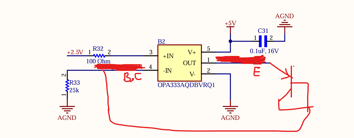

Subject: Help Required: Phase Margin and Gain Margin Analysis of Op-Amp Current Source
Hello TI Team,
I am evaluating an op-amp-based voltage-to-current source for my system and would like to verify its stability.
Could you please help me with:
  1. How to measure phase margin and gain margin in TINA-TI, including the correct loop-gain simulation setup and interpretation of the Bode plot.
  2. How to perform the corresponding hardware stability measurement without a Frequency Response Analyzer/Bode plot analyzer. I would like to know a practical method using equipment such as an oscilloscope/function generator.
  3. Please suggest easy-to-understand TI literature/application notes for this analysis.
  4. If possible, could you please provide or modify a TINA-TI simulation file for my exact current-source circuit so I can understand the complete procedure?
My circuit is a voltage-to-current source for a constant-current application. The current-source schematic is attached.
Ron Michallick  , you previously helped me with a similar simulation in my earlier E2E post. Ron, could you please help me complete the stability analysis for this updated circuit in this new thread? circuit is same
