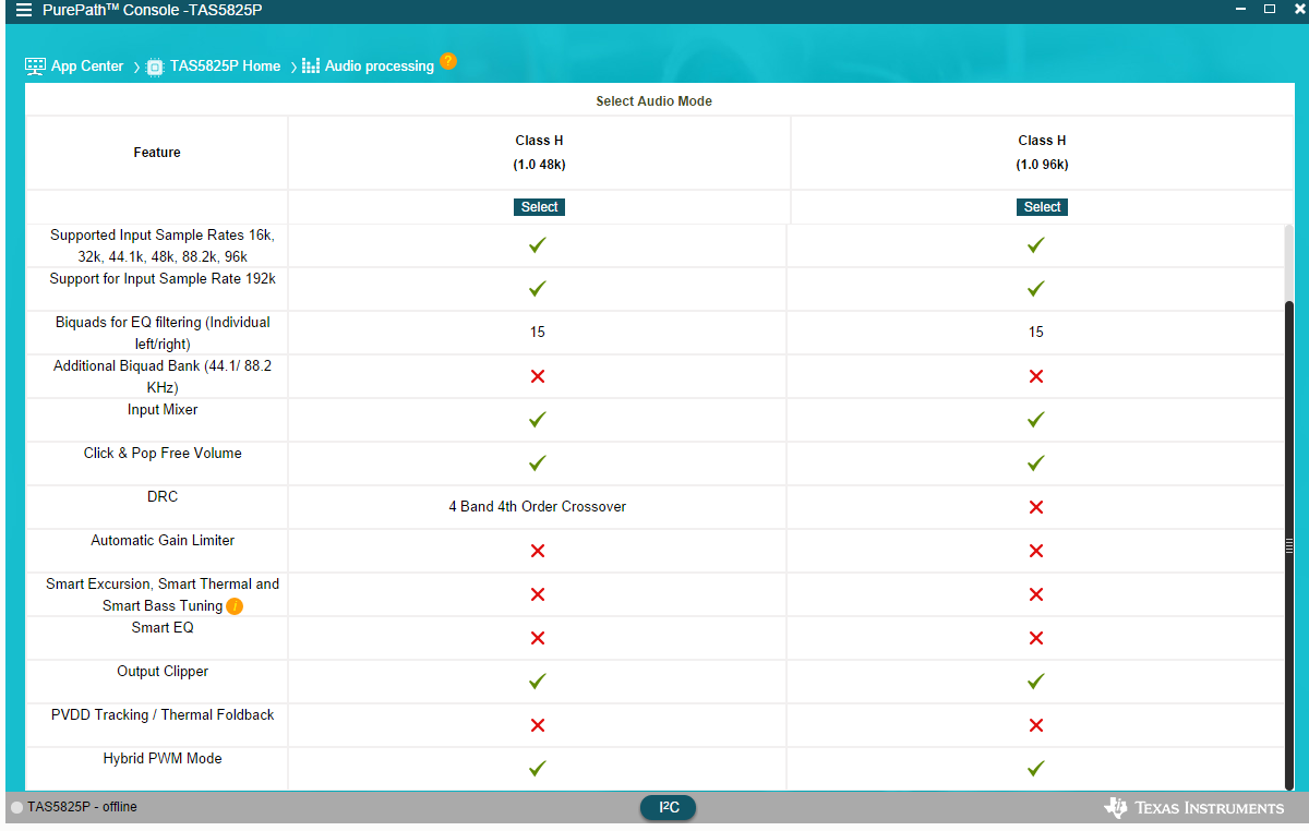

PPC3's TAS5825P app only offers Class-H process flows (confirmed via Mono 1.0 PBTL, both sample rates). Our board (TAS5825M/P, fixed PVDD, no boost converter) needs a plain, non-Class-H flow matching what our existing production firmware uses (tas5825m_dsp_default.bin, 7117 writes, no Class-H architecturFLOW.pnge). Which PPC3 app/device profile produces that kind of flow for this chip?"
