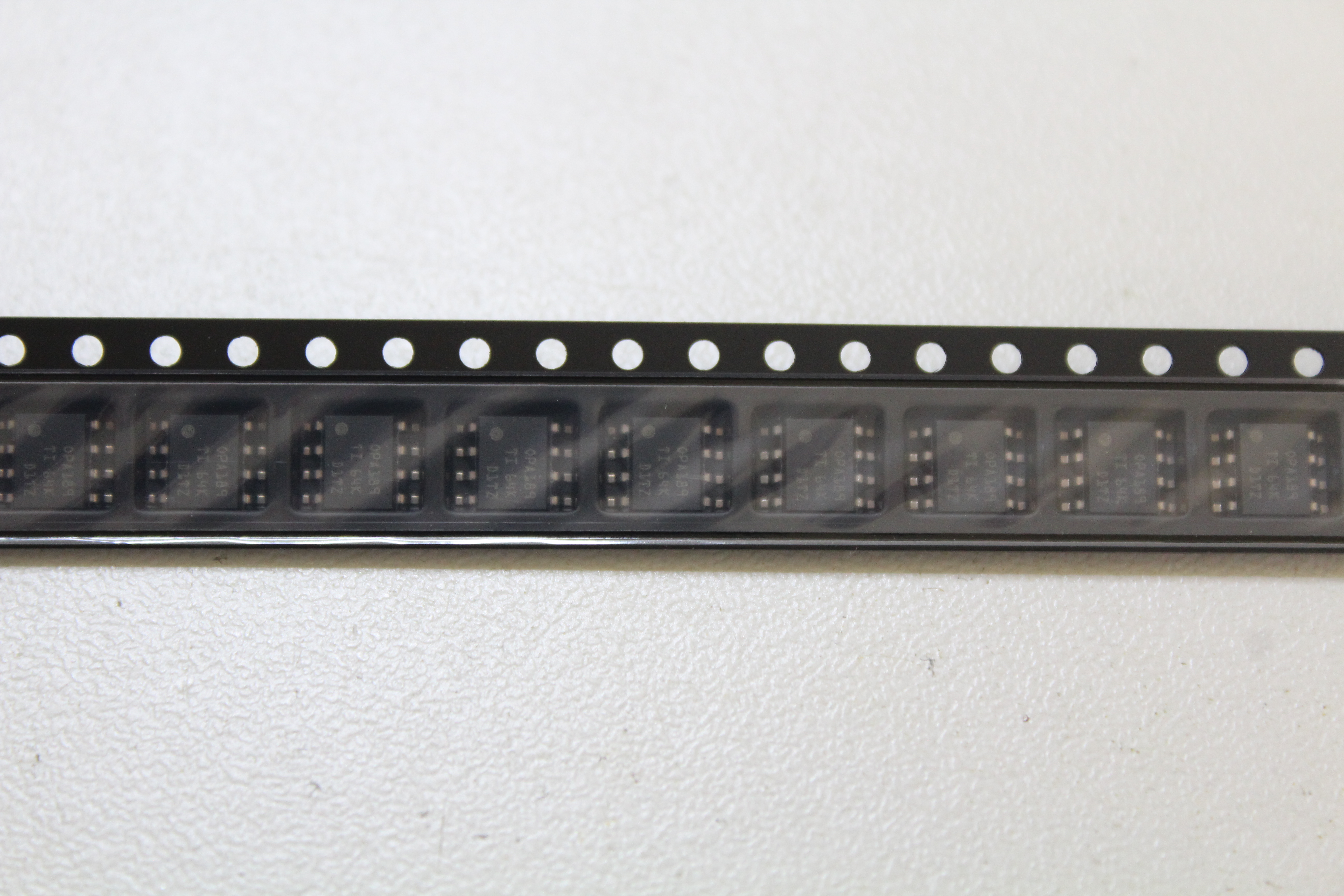

Please advise, the customer has raised the below questions regarding OPA189IDR:
Pictures also attached
"We would appreciate your assistance in verifying whether the operational amplifier shown in the attached photos is a genuine Texas Instruments product and whether the two components are completely identical.
In addition, we would like to know the exact meaning of the codes and markings printed on the devices. Unfortunately, we were unable to find any information regarding these markings in the datasheet.
Product details:
  • Item Number: 99451506036890
  • Description: IC Amplifier OPA189IDR 1CH 14MHz R-to-R SOIC-8 (TI)
  • Part Number: OPA189IDR
Thank you for your help in advance.
  • Hi Mitchell,
    The markings on the die are for internal lot tracking and environmental category, as indicated by (4) shown above in the datasheet screenshot. I was able to look up the devices above, and they are genuine TI devices that were manufactured in October of 2023.
    Please let me know if there are further questions.
