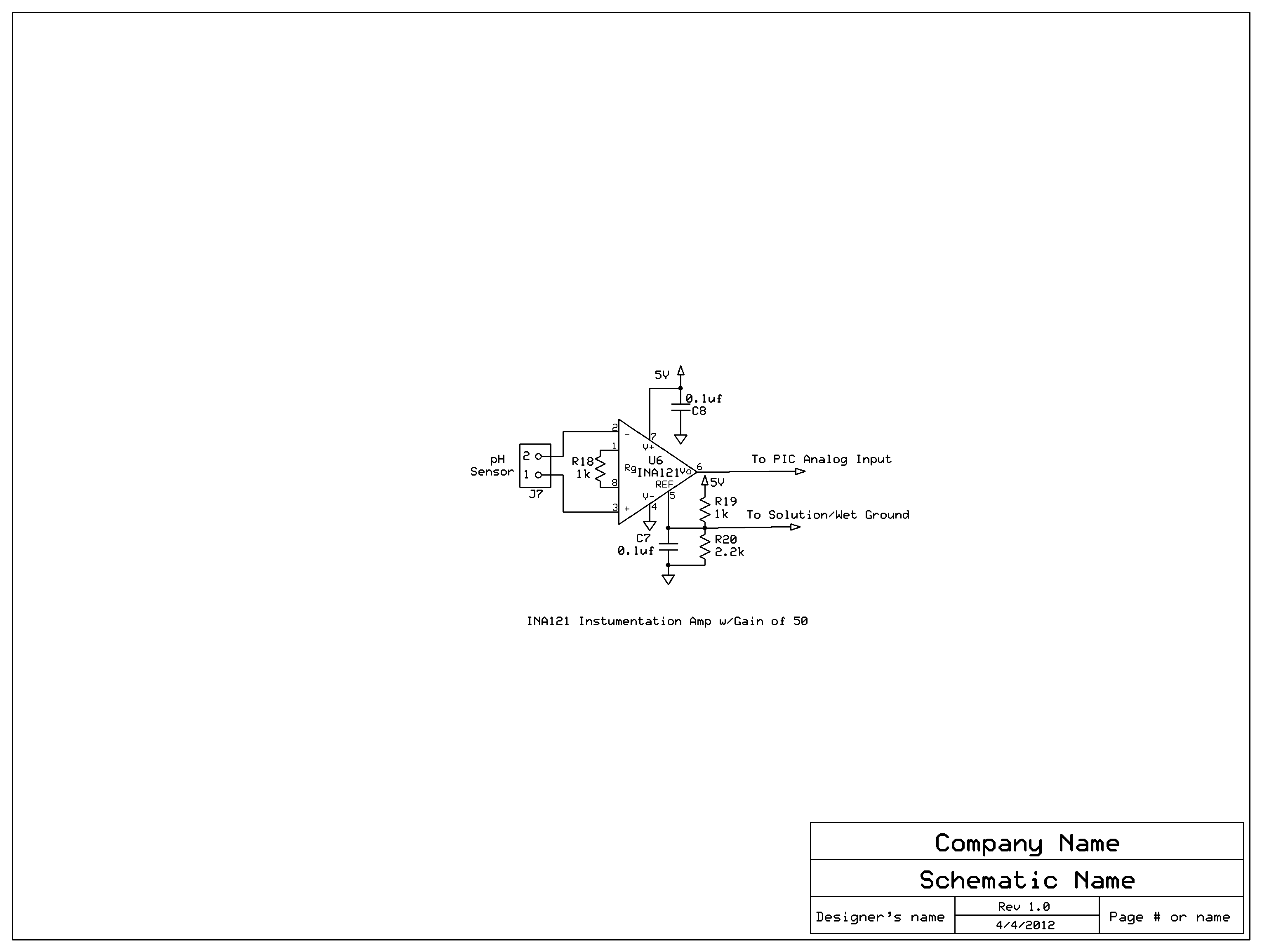

I have breadboarded a pH sensing circuit using the circuit shown on page 9, figure 7 of the INA116 data sheet using an INA121, and it works somewhat as expected.
Notes: I have V+ at 24 v, V- at ground, and Ref tied to a resistor voltage divider to provide a voltage offset on 3.5v to shift the pH swing (6.5 - 8) into the input range of a PIC ADC. I also use this voltage as the "Solution Ground". I am using a gain of 50. The pH sensor provides a +/-0.059 volt change for every unit of pH, with a pH of 7.0 being 0 volts.
I have now had boards made and the circuit does not work. I have cleaned the boards to insure there is no stray resistance.
Any assistance would be GREATLY appreciated!!!!!
