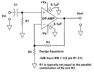

in above ckt these are values.
C1=150uF
R1=10k
R2,R3=20k
VS=12 and -12v,
Vin has a Accelerometer whose output is around 9 Vdc+AC signal. when it is at rest i see 200mv peak to peak noise in the wavefom. but if i replace R1 with 100 and r2,r3 to 200 that noise come down to 10mvpp. what is wrong with above ckt?
  • Even if we take into account only  the noise of the resistors  which is proportional  to the SQR(4kTR) we will see that  noise performance will be better for the circuit  with less ressistance value.

    You have not described the nature of the noise you are seeing. A description or scope photo would be helpful. My best guess is that the noise is coming from the sensor, not the amplifier. Changing R1 to 100 ohms could very likely be loading the sensor, reducing its output. This would account for the reduction in noise but would not be a cure for the real problem.
    Changing R2 and R3 to 200 ohms is not recommended. This creates a very heavy load for the op amp and there is no value to matching the DC resistance on the inputs of this amplifier because it has internal input bias current cancellation. For an explanation you can refer to this discussion...  http://e2e.ti.com/blogs_/b/thesignal/archive/2012/04/17/internal-input-bias-current-cancellation.aspx. I recommend R2 = R3 = 10k ohms regardless of the value used for R1.

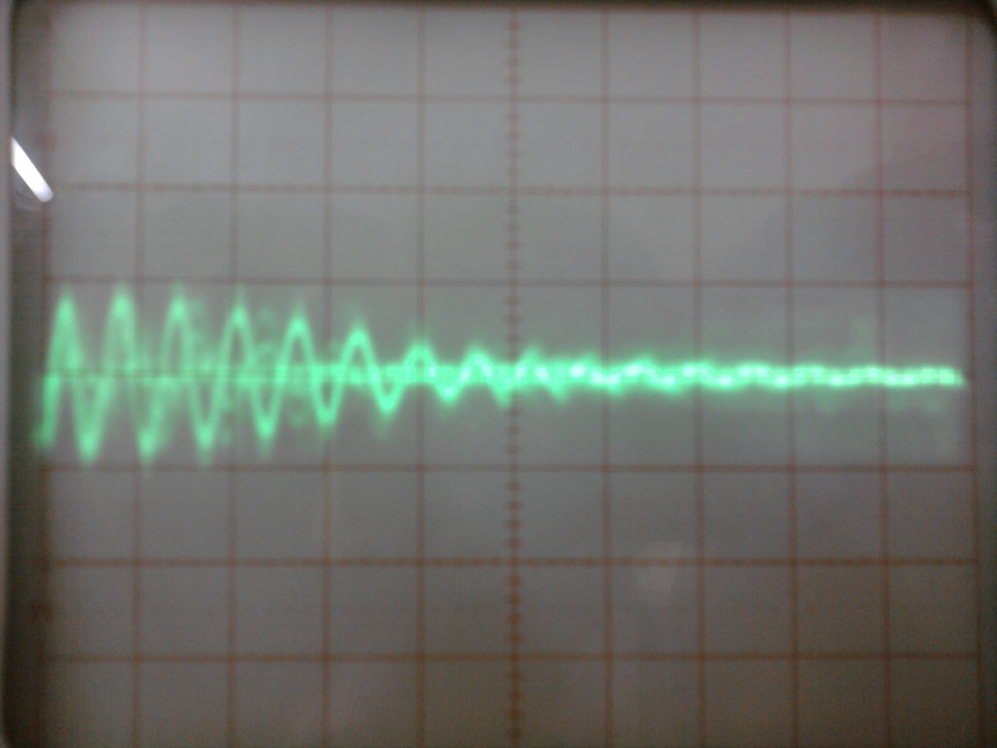

    The fact that the "spikes" are still there when you replace the LM334 circuit pretty much rules it out as the noise source.
    I think you are seeing power line noise pickup. 5mVp-p of noise is not uncommon.
    At 50K samples over 1 second, that's 20ms/sample. 60Hz is 16.6ms - so I think you are seeing an aliasing of the 60Hz/120Hz noise as the "spikes". Speed up your sample rate to see what the actual waveform look like. Otherwise, use the analog scope to see what is happening.
    Your circuit has an impedance of about 250 ohms (dominated by the sensor output impedance). That is high enough to be able to "pick up" noise by any unshielded wires.

    Turing off  one of the UPS for computer in lab greatly reduce the noise, now when i put resistor as a load for LM334  i don't see any noise. But when i connect sensor, noise appears as shown in below images. Now GPB  is into the shielded box,  those are some of images with sensor connected .
    Horizontal  deflection 0.2 us/div,  vertical deflection 50mv/div
    Horizontal  deflection 2 ms/div,  vertical deflection 50mv/div
