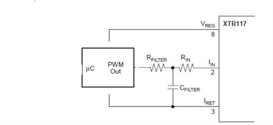

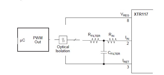

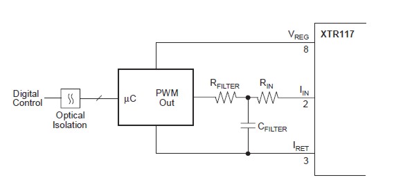

I want to interface the XTR117 to a standard 3.3V MCU  pin with PWM.  In the datasheet it has examples of digital control.  I am a little confused about what digital control means here.  My understanding would be that the MCU was the digital control and for the diagram below I would have thought that the opto-isolator would go between the uC and the Rfilter.
Can I connect the PWM output of my MCU to the filter directly without an opto-isolator as in the last diagram?
This is my understanding of Digital Control.
This is ideally what I want to do.  The XTR117 is so small that I don't want to waste time soldering it or building a circuit board just to test it.  The end use is just a demo for testing.  It is a last minute addition to a prototype and the box is already crammed full!!!
    Your final diagram will work fine as long as the uC in your diagram is powered from the XTR117 VREG pin and the GND of the uC is connected to ONLY the XTR117 IRET pin.  The XTR117 is a 2-wire transmitter and the entire sensor, input, and control circuitry must float above the IRET pin so that when the output current of the XTR changes the sensor and input circuitry biasing and other voltages do not change.  Therefore if a uC is added to the 2-wire loop then it and all of its communication voltages must also float with the XTR supplies.  This doesn't pose a problem for communicating to another other device that is also powered between the XTR VREG and IRET, but any device powered to a "system" Power and GND will not be able to communicate with the uC without some type of isolation based voltage level shifting.  The optocoupler is shown to provide this isolation based level shifting because if the microcontroller needs input from another controller or device in the system that is not part of the remote 2-wire loop then the communication must be isolated so that the signals going to the XTR117 uC are able to float with the XTR VREG and IRET.

  • I should be able to use second diagram for my application, using +5 Vreg from the XTR117 for the opto-isolator, correct?
  • Hello Greenja,
    Yes, the concept is very similar to the MOSFET driving circuit you mention.
    It seems you're back on the XTR117.  Have you decided that you do need a 2-wire transmitter?  If you provide more information about your application I can probably help more.
    If you're using the XTR117 then the second diagram should work fine.  Bias the driving side of the opto-coupler to the control circuitry voltage potentials and power the receiving side only between the XTR VREG and IRET signals, basically the same connections shown for the DAC.

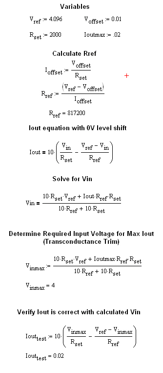

    4. Where are the calculations for figure 47 if I want to use other voltages?

    4.)  There is actually an error in Figure 44 of the datasheet, the value of the reference resistor should have been 98000, not 120,000.  The values in figure 47 are correct.  There are a few important equations, they are listed below:
    Variables:
    Vref:  Reference voltage supplied to the reference resistor (4.096 in Figure 47)
    Rref:  Resistor between the Vref voltage source and the SET pin of the XTR111 (817.2 kOhms in Figure 47)
    Rset:  Resistor between the SET pin of the XTR111 and GND (2 kOhms in Figure 47)
    Voffset:  Desired input voltage to produce a 0A output current from the XTR111
    Ioffset:  Offset current required to cancel the offset voltage so the XTR111 has a 0A output.
    Ioutmax:  Maximum output current.  In a 4-20mA system Ioutmax = 20mA.
    Calculation for the resistor between the reference voltage and the SET pin:
    Ioffset = Voffset / Rset
    Rref = (Vref - Voffset) / Ioffset
    Calculation for input voltage required to produce the desired maximum output current, Ioutmax
    Vin = (10*Rset*Vref + Iout*Rref*Rset) / (10*Rref + 10*Rset)
    I've included an image of a MathCAD file I use to calculate these values because it may be easier to read:
