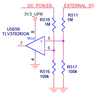

    And I agree - It's all about compromises. I guess the reason I'm so "scared" about connecting both inputs to same potential is as I once by mistake shorted the two signals DC_POWER and EXTERNAL_DC using a 0R resistor (so both nets got the same 12V) on the schematic below, which made the output of the TLV3702 oscillate like crazy (like 2MHz AFAIK).
    As it seems you are more into analog input stages than I am can you explain why this would cause this comparator to go totally bananas? Is it due to the resistors together with a slight change in input current passing through them then when the output changes? Or any other good reason you can easily come up with that would cause this circuit to oscillate like crazy? And secondly: Why wouldn't this problem occur on the device discussed above if both inputs are tied to same potential (GND)? Because of no big resistors in path and/or because of the offset voltage?

  • Hi Søren,
    Most likely the offset was low and close to the noise threshold. Every circuit is different so it is hard to say just why your circuit oscillated. Most likely it was either capacitive coupling between the input and output pins - or - glitches through the power supply.
    Comparators draw large currents when the output changes states (up to several mA in several ns), and can "droop" the supply if not properly bypassed.
    Your circuit above has a ~100Kohm input impedance, which could allow the output transients to couple back into the inputs through a few pF of board strays. That's all it takes!
    So if you want to feel safe, ground one input and lift one to a convenient voltage several mV above ground. That voltage could be from a resistor divider or an available reference line.
    If the comparator is a bipolar open-collector comparator (LMV339/393 series), set the output high as to not waste base current in the unused output transistor (save a few uA in supply current).
