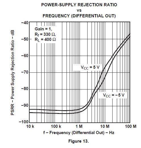

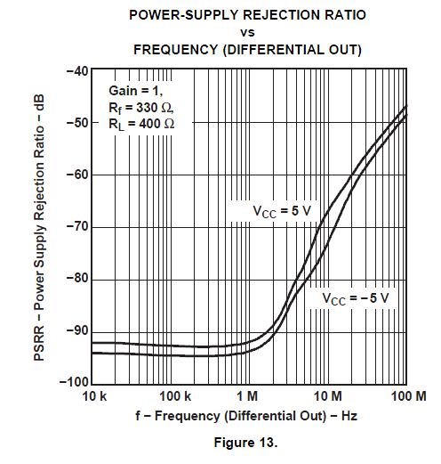

My customer would like to see the attached PSRR vs Freq graph (Figure 13 of the THS4130 datasheet) redone to show each output ("Vout+" and "Vout-") separately (Single-Ended) rather than differentially.  Can someone in the product group please perform this characterization and post the results.
