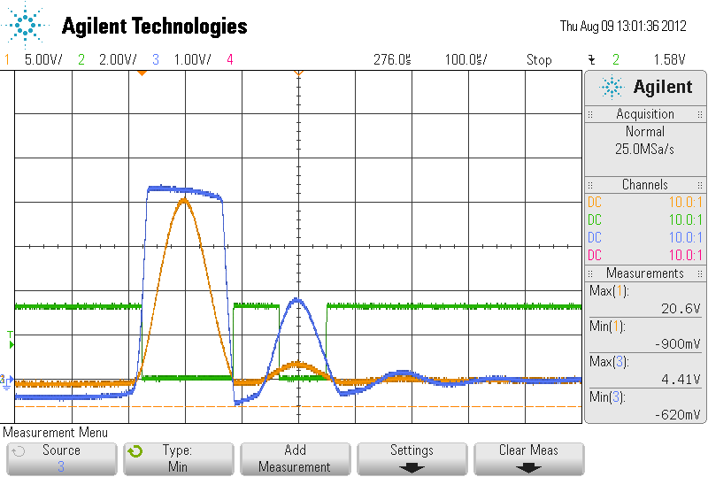

    If the inverting input is driven beyond (V+)+0.5V will the output invert?  Please see attached oscilloscope plot.
    The orange trace is the input to the circuit.  The blue trace is the inverting input of the TLV3011.  (Note, there is a 10kOhm resistor between the input of the circuit and the input of the comparator.)  The green trace is the output of the comparator.  V+ = 3.3V.
    My concern is the output might invert; it did not on this example, but this is just one part.

    I just set up a TLV3011 in the lab and tested it with the inverting input being over-driven by as much as 0.5 V beyond the supply rails, the input signal absolute maximum. The comparator output did not invert and did not show any tendency to do so. Most modern operational amplifier and comparators are designed not to invert when over-driven and that is the expected behavior of the products today.
    Also, when I mentioned that the TLV3011 doesn't have an ESD steering diode to the positive supply rail I was basing that on the internal schematic diagram. While in the lab I checked for a diode between the inputs and the negative and positive supply rails. Indeed the negative diode checks from a simple ohmmeter test and also a DMM diode check. The input to the positive rail showed a multi-Megohm resistance, but not a diode-like characteristic. The diode check produced a voltage unlike the typical 0.65 V level seen for a diode. It probably was a leakage resistance path being developed within the unpowered device. Therefore, all indications are there isn't a diode between the input and positive supply rail.
    I suspect the Vcc + 0.5 V limit was set to assure that the CMOS input stage is protected from over-voltage and also prevents the normally off ESD cell from being triggered on.
    I hope this helps answers your questions.
    Regards, Thomas
