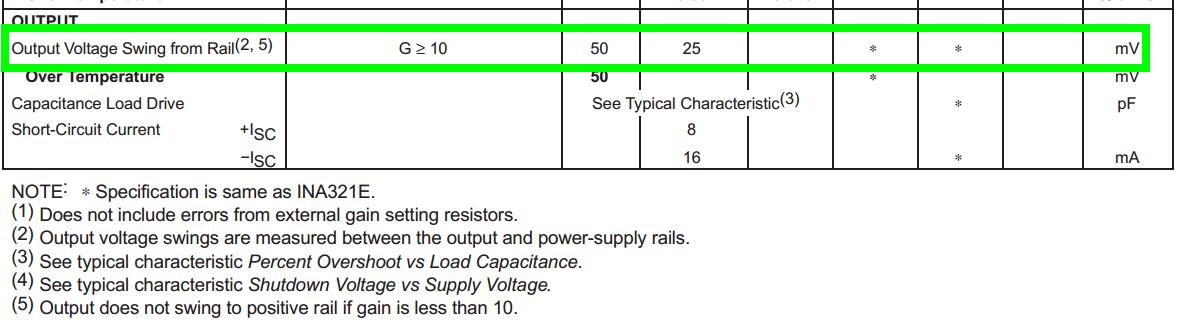

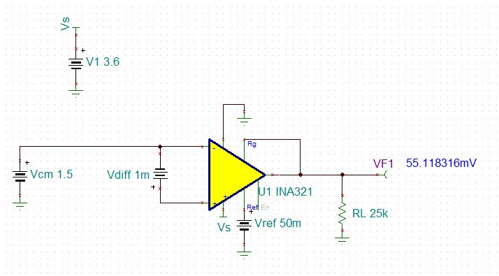

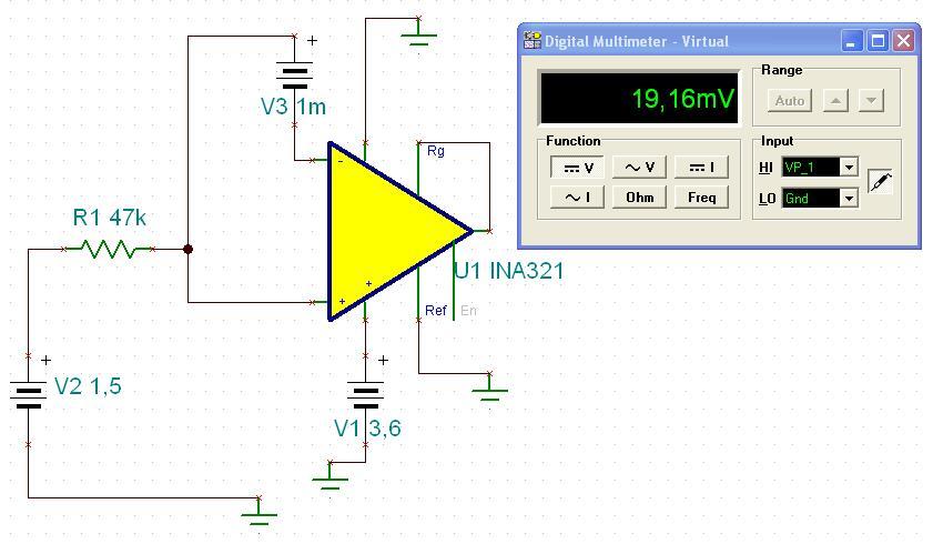

Hi, I am testing TINA with INA321:
The vout should be 5 X 1mv (GAIN X Difference input) = 5mV, but voud = 19,6mV.
What is wrong?
INA321 Datasheet: http://www.ti.com/lit/gpn/ina321
