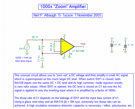

             I recently saw this circuit in the examples of TINA by Neil P. Albaugh. This circuit amplifies the AC component of a signal and eliminates the DC part. I just wanted to know if there is  any other circuit that amplifies the AC part but leaves the DC part unaltered. I have attached a screen shot from TINA below.
