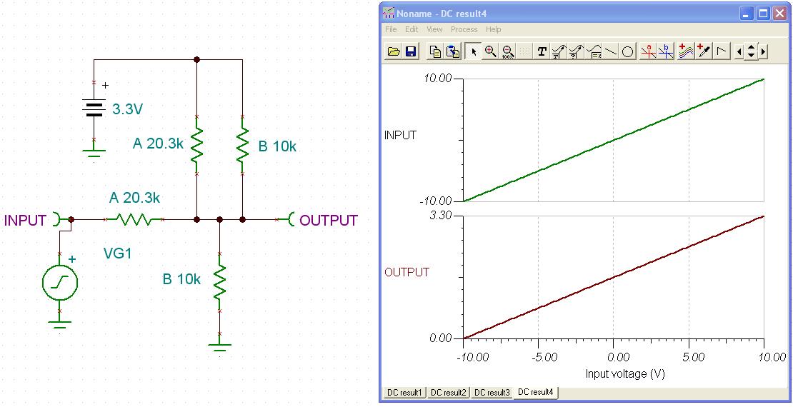

I have simulated a +-10V to 0-3.3V bipolar to unipolar circuit.  Although it works in the simulator, I would like to know if there are any design issures, particularly with R1 having such a low value.  It is being fed into the Analog input of a MCU (CC2540, MSP or Stellaris LM3S/LM4F).  Exclude the choice of Op Amp from the analysis unless there is a crucial flaw in the choice.  I have lots of them and haven't had any issues with other unipolar designs.
VCC is a precision reference 2.5V
