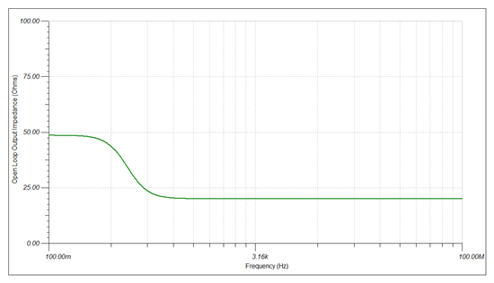

    The OPA132 can be considered the "old-fashioned" version of the OPA140. Although its open loop output impedance is not characterized in the datasheet, the spice macromodel can be used to generate a reasonable approximation:
    While this will be a fairly accurate representation of the open loop output impedance, the designer (Marek Lis) asked me to caution that since this is an older spice macromodel that its does not model many other characteristics as accurately as our new models. I've attached the Tina file used to generate the plot if you would like to simulate this yourself.
