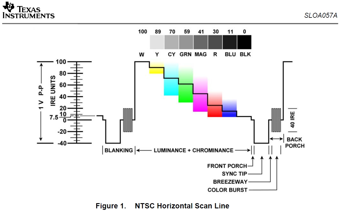

I will design my first video circuitry and need some information about video systems.
Main issue is video signal peak to peak amplitude. I have checked some of the reference design and see that composite video output varies between 0.7V to 1.3V after on board 75 Ohm termination.
It is confused me, because all documents states that the peak amplitude as is 1Vpp for 140 IRE.
Is there an Automatic Gain Control circuitry on receivers like TV sets? How the receivers restores the DC levels?
I will design a video amplifier but not sure about gain requirements. Could you please share your experience or reference a document or an application note ?
