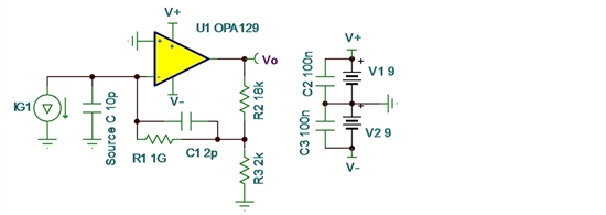

    Here it's the circuit idea (based on OPA129's datasheet typical circuit). It's a simple I to V converter. Current range starts at 1 fA to 1 nA (approximately), with an accuracy of +/- 0.01 nA. The issue with the simmetry is related with experimental observations, because the best performance (voltage measurement's reproducibility) was obteined applying a battery voltage divisor like it's showed in the diagram. Although I'd like supply the circuit with a dual power supply. Sincerely, it could be an incorrect interpretation of the datasheet info, because I'm just starting in the electronics world.
    What do you think about it?
    The current input is at pin 2. All the circuit was tested into a Faraday cage (to avoid electromagnetic noise).

    I don't see any real need in your circuit for accurate symmetry in the power supply voltage. I think it would simply your circuit greatly to use two 9V batteries as shown below. C2 and C3 should be located close to U1.
    Note that a 1nA input signal would overdrive the amplifier, attempting to create 10V output.
    C1 will be required for stable operation. The optimum value for C1 will depend on the capacitance of your source and stray capacitance. Depending on this capacitance, you may have difficulty getting sufficient bandwidth. It may be better to eliminate the extra gain from R2/R3. You could use a second op amp for more gain, if necessary.
    Regards, Bruce.

    The OPA129 is a good choice for this application. You could use 7812 and 7912 regulators for the power supplies. I suggested batteries to avoid the hassle and eliminate any possibility of external noise if you wanted to put them inside your shield.
    The maximum input current is related to the transimpedance gain and output voltage swing capability of the op amp. The output limitation of the op amp is approximately 2V from each supply rail (+/-10V for +/-12V supplies). With a 1G-ohm x 10, your present circuit would reach 10V output with a 1nA input current. It would have overloaded at a lower input current with your previous 9V/2 circuit.
    What is your source capacitance? You could have bandwidth limitations.
