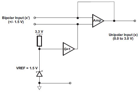

The inputs of a ADC ( TMS320F28335 ) is in the range of 0 to 3 Volt.
The outputs of a transducer is in the range of -5 to 5 Volt.
It is required to shift the output signal of the transducer to 1.5 Volt and to decrease its amplitude.
I can use the below circuit.
Also I saw the the below circuit in a TI application note.
May there is other solutions, I don't know!
Q1- Which solution is better?
Q2- Is there a dedicated IC for this reason?
Q3- Please suggest me a practical circuit ( contain IC number )?

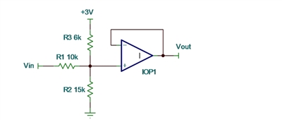

  • Ras,
    I think this circuit will do what you want. Do you have a 3V reference? Op amp selection will depend on speed, accuracy and power requirements.
    Regards, Bruce.

  • Ras,
    Your second circuit (with resistors added for proper operation) would be inverting. It would provide 0V output with 5V input and 3V output with -5V input.
    Your first circuit is essentially the same as my circuit. V1 is the input. V2 is the reference voltage. With R2 in my circuit, the op amp can be connected in G=1. The circuit I suggested uses the minimum number of components.
    Regards, Bruce.

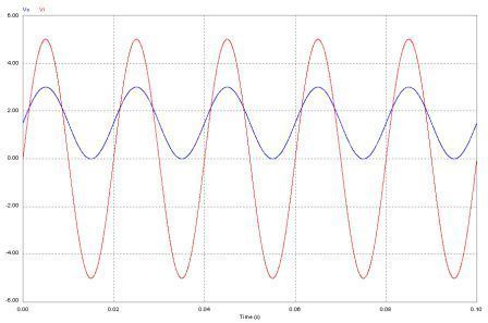

  • Dear Bruce,
    I simulated your circuit.
    The waveforms are as bellow:
    The results are satisfying.
    I have the previously questioned; Does the reference voltage circuit have superiority over this circuit ( divided voltage )?

  • Ras,
    Sorry but I should have explained that this circuit cannot function properly without a reference voltage of approximately 2.2V or greater. The LM4140 has 2.5V and 4.096V versions. Here are the circuit values required for several common voltages:
    Vref = 2.5 3 3.3 4.096
    R1= 10000 10000 10000 10000
    R2= 30000 15000 12222 8988
    R3= 5000 6000 6600 8192
    It is better to use a quality voltage reference. The power supply may not provide sufficient accuracy and temperature stability for accurate offsetting.
