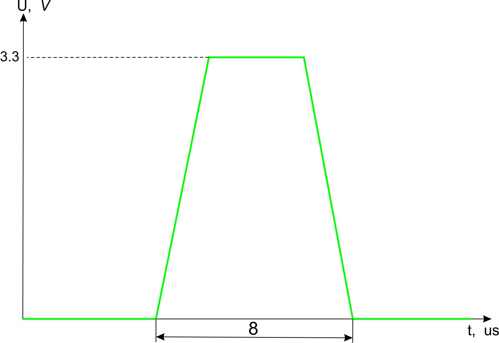

I'm developing trapezieform pulse generator. The pulse is synthesized directly by FPGA and DAC. The pulse has 3.3 V amplitude and about 8 us width (see picture).
So, I need an amplifier to increase the amplitude to 130 V with minimal pulse form distorsion.

  • Maksim,
    It appears that the rising and falling portions of the waveform occur in approximately 2us. This would require an amplifier with a minimum slew rate of 65V/us which is faster than can be achieved with our standard high voltage amplifiers.
    Our OPA453, for example specifies a typical rising slew rate of 23V/us. It has a maximum operating voltage of 80V, In bridge mode operation (BTL) it could provide the required output voltage swing but with a maximum slew rate of approximately 40V/us. This would distort the shape of the output waveform significantly.
    So it appears that we don't have an easy solution for your requirements.
    Regards, Bruce.

    Rising and falling portions are 2 us for this drawing, yes. But it is only an example. In fact, we need to provide 8 us in total and portions ratio can be different (3+2+3, 1+1+6, so on).

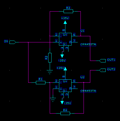

  • Bruce, do you mean this circuit under bridge mode connection?
  • Maksim,
    Sorry for the delay. Yes, your schematic shows a bridge output configuration. Note that this does not allow the load to be ground referenced. The load must "float" between the two amplifier outputs.
    The output current of the OPA453 obviously falls far short of your 3A goal. While it may be possible to boost the output current with external transistors, this type of circuit can be quite tricky to implement. The OPA453 is not unity-gain stable, allowing it to achieve relatively high speed. This make it much more difficult to add current-boosting output transistors inside the feedback loop.
    Regards, Bruce.

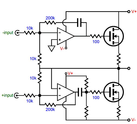

    So, may be there is more reasonable to use stage based on MOSFETs as shown below?
    With regards,
    Maksim
  • Maksim,
    The design and optimization of a push-pull amplifier of this type can be very tricky. If you attempt to develop such a circuit, be prepared for considerable study and effort. At the voltage, current and speed you are seeking, you will likely need an ample supply of spare parts. I also recommend keeping a fire extinguisher nearby. This is not an easy "cookbook" project.
    I see problems with the circuit you have provided. Fundamentally, I believe that any circuit with upper and lower output transistors controlled by separate op amps is likely to create trouble. It is very easy to turn both transistors on at the same time, drawing high current and creating massive power dissipation. Successful designs of this type generally use a single op amp that can supply a drive signal spanning the full output voltage range. As we discussed, we do not have an op amp with sufficient voltage range to do this which is the reason for bridge operation.
    Regards, Bruce.
