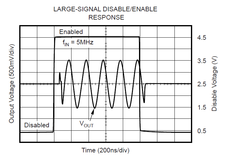

Hello, I've used OPA355. I need to cut INPUT pulses in 4 useg , the enable pin is used for this purpose, but in the output appears a glitch when the OPA is enable again. How can I eliminate or attenuate this glitch?.

Hello Jaime,
How large is the glitch that you are seeing? Do you have a scope shot? Also, can you tell us a little more about the circuit/input signal? A schematic would be helpful.
If you look at page 5 of the OPA355 datasheet, there was a test performed with a faster pulse that appears to show about a 500mV spike before tracking the input signal. Is this what you are referring to?
