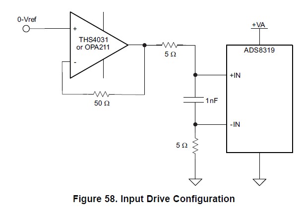

looking for a diff. amp. to drive ADS8319 (16bit SAR),like LTC6362, or ADA4941, for 3.3V.
Is THS4531 is a right solution?
I am worikng on similar competition (ADA4941-1 and LTC6363) for 18b SAR ADC driver. ADA4941-1 is not real FDA but like.
I found THS4531A is good at Vos drift. LME49724 also be good at Vn if power consumption is acceptable. I am also considerring PGA280 (no external trim R, wide input range..etc.) if package size is okay.
