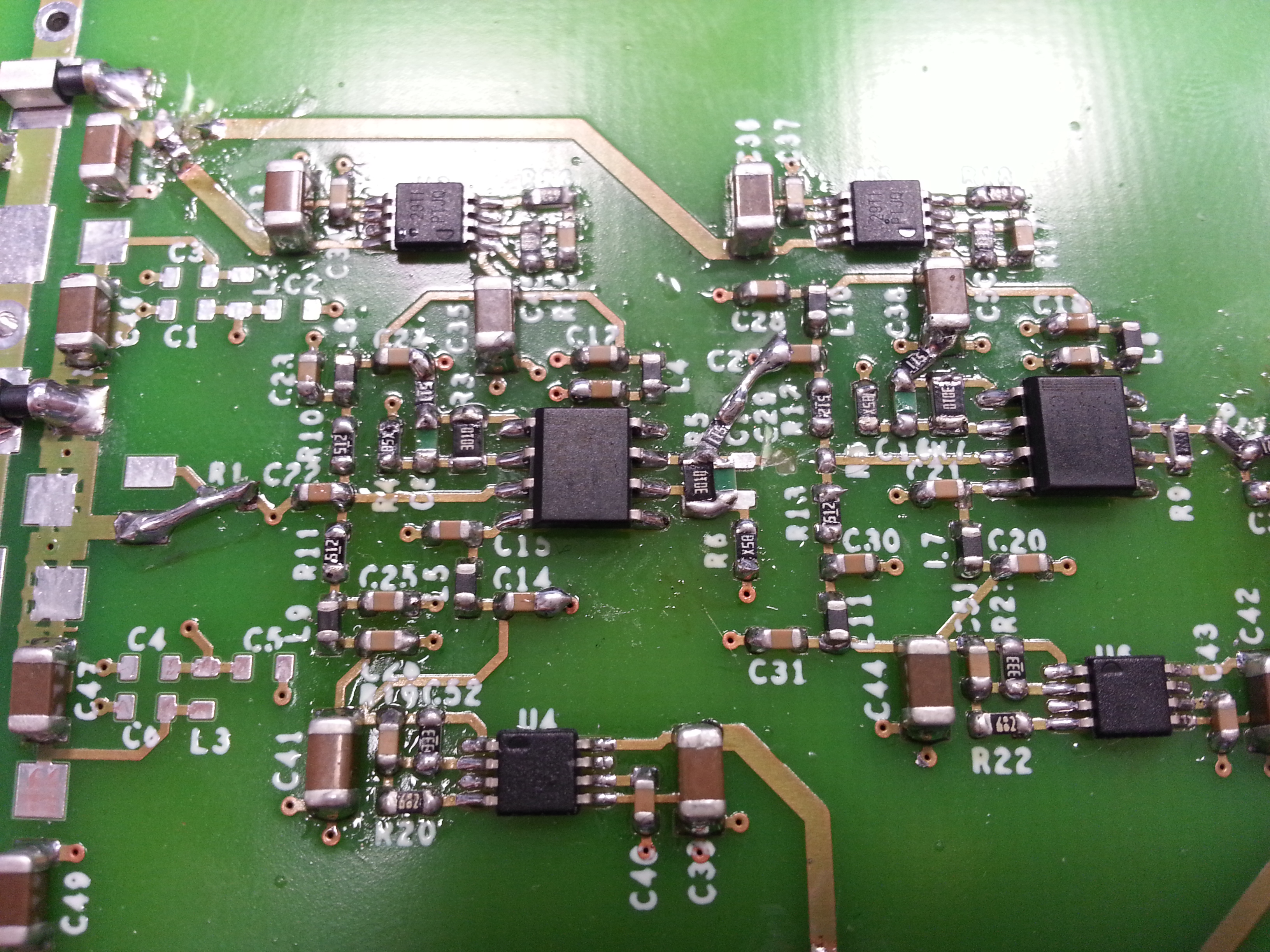

I'm having an usual problem with the THS3202.
If you look at my schematics here: 8004.schematics.pdf
You'll see that I'm cascading 2 THS3202, one with a total gain of 25 (2 times 5) and another with a gain of 5 (5x gain + follower).
If I connect GND to the left node of C22, remove C29 and measure the voltage (referenced to GND) at R23 I'll see a 460MHz ringing.
However, on the right side of the circuit (5x gain + follower), I find the usual behaviour of the THS3202
PCB layout is shown here:
PCB is two layers, the other side is an uninterrupted ground plane, except for a void area around the text "R1".
Would anyone have an idea of what can cause this ringing?

  • Matthieu,
    The most likely cause for the ringing you observe would be the light compensation of the THS3202 in a gain of +5V/V.  The datasheet, figure 10 & 11, shows ~2dB of peaking for 340ohm in the feedback resistance.  The capacitor across the feedback resistors, C8, C10 & C16 may help flatening the response, but in general it is not a recommended implementation for a current feedback amplifier as it may destabilize it.  The first THS3202 is likely to exhibit the problem more as there are 2 stages with the same peaking adding the overall peaking for that stage.
    I would recommend removing C8, C10 and C16 and increasing the feedback resistances to 420ohm.  Rg would then be 105ohm.
    Xavier

  • Mathieu,
    I have 2 comments on this:
    1) I notice the output of Amp A directly feeds into the + input of Amp B on both stages. In theory this is fine as the + input is high impedance. However, the input does have capacitances associated with it which can impact high frequency stability of the driver amp. It is recommended to place a 49.9-ohm resistor in series on each output to + input.
    2) It is possible that the Power supply filter circuit you have may be impacting this situation. PSRR at such high frequencies of any amplifier is not the greatest, and the power supply filtering can play a role. Sometimes experimenting with the Ferrite (some ferrites have very high Q, be sure a low Q ferrite is utilized) and/or the capacitors may have an impact.

  • Hi Mathieu,
    As you are changing the frequency of the ringing, you have most likely found the loop in which it is created.
    Changing the gain for each stage to be 4.35V/V should help.  The reduction in the PSRR at high frequency may be the cause for the ringing or some of it anyway.  This is describe in the following blog.
    http://e2e.ti.com/blogs_/b/analogwire/archive/2013/02/01/xavier-ramus.aspx
    Since you have separated the power supplies for the first THS3202 vs. the 2nd THS3202 and that the 2nd does not exhibit the problem, spreading the gain away from the first stage may help.
    To help isolate whether the PSRR/gain is the problem or whether the compensation of the amplifier is the problem, I would recommend to use 1kohm in the feedback for thsi test, to make sure that the ringing is not due to other parasitic issue such as a long trace on the non inverting input pin that may require isolation.
    If the problem still persist with 1kohm feedback with 5-5-5-1 gain, then spread the gain to 4.35-4.35-4.35-4.35, then reduce the feedback to 420ohm if the problem is still not present.
    feeding the negative input of teh 2nd amp would help only if the issue is related to board parastic, but would not help if the issue is due to the lack of PSRR of the amplifier at high frequency.

  • Hello everyone,
    Things are getting quite weirder.
    I just implemented the following schematics on the existing PCB (without R28 and R30, and without powering U2): 7573.schematicsv2.pdf
    If I measure the voltage (coax cable with a 50ohms resistor at the end) at VIN2+ when powering the system, it will oscillate only after 6 or 7 seconds. If I measure the voltage after having powered the system it will be already oscillating.
    I also switched to RF ferrites (BLM18EG601SN1D)
    The oscillation (550MHz) doesn't really make sense to me as I only have a total gain of 3.38*3.38=11.42 at U1.
    Would anyone have an idea?

  • Hello everyone,
    It turns out that we can't power the THS3202 using +7/-7V when using the SOIC package.
    I'm quite disappointed of seeing no warning in the datasheet. Using a homemade heatsink, the temperature difference between the die and the top of the SOIC package is too big, and therefore the THS3202 oscillates.

  • Hi Mathieu,
    good work. I like it :-)
    As you said, it's a temperature issue. However it's not related directly to the SOIC package that can work at the rates you've mentioned as long as you don't exceed the maximum. If you check some datasheet figures you´ll see how temperature degrades offset, output current source and also the power supply rejection ratio - a potential cause of the described oscillation.
