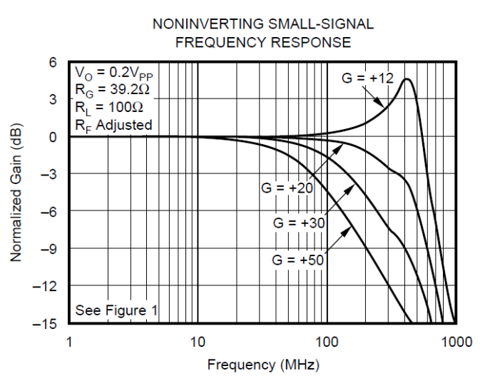

For the beginning I want to simulate small signal with the simple circuit shown on the Fig, 1 Page 10 in the datasheet. After this simulation I should get the frequency response curves for the noninverting small signal on the Page 4. For instance for the G=+12 the -3dB Bandwidth schould be arround 600 MHz. This value is also appeaars in the electrical characteristics. In fact if I simulate the circuit shown in Fig. 1 I get ca. 420 MHz instead of 600 MHz for G=+12. What is wrong?

    That being said, the OPA847 is a decompensated amplifier that operates the best at gains above 20V/V. It can be used below that, but as you can see the gain starts to get quite a bit of peaking around +12V/V. Note that about 6dB of peaking is a sign of instability. For a good stable design, you generally want a flat response (some peaking is ok, ~3dB or so), and you want to be operating in the flatband.
    Even though this is stable and you get more bandwidth, you really wouldn’t want to design your circuit to operate that close to the cutoff frequency or rely on the peaking for "enhanced gain".

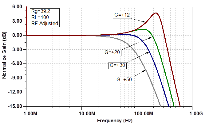

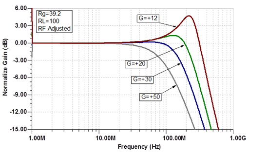

    I ran the simulation with the conditions shown in the datasheet and found that the curves were actually very close at high gains. It is just the lower gain responses that are off. This is expected though, because a SPICE model is generally optimized for stable conditions for general purpose use. This allows for the greatest number of use cases and still demonstrates the basic capabilities of the part.
     Also keep in mind that this is on a log scale, so small changes in response can actually turn out to be over 100MHz difference in bandwidth.

  • Luke,
    Many thanks fpr the answer. Your simulation looks very close to the datasheet.

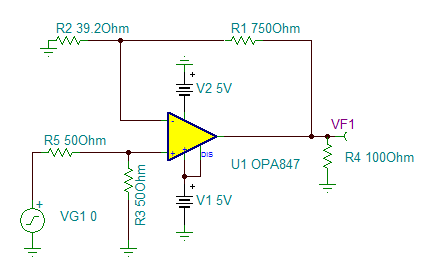

    The values I used to get my plots were:
    G=12; Rf=430 Ohm
    G=20; Rf=750 Ohm
    G=30; Rf=1.1 k
    G=50; Rf=2k
    Try these out and let me know if that helps.

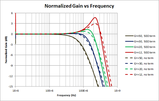

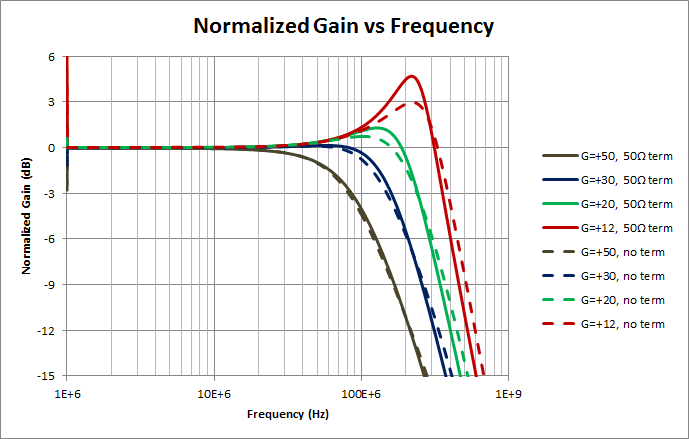

  • Juri,
    I send you a message with my e-mail included.
    Also, in my simulations the bandwidth shows about 400MHz or so for a gain of +12V/V as well. This is to be expected as discussed previously.
    The other thing to point out. You said you simulated without the 50Ω input termination, but this actually changes the response (see below).
    It is more accurate (and true to how it will be used in the system) to include it. I simulated with the config below.
    Let me know if this helps.
    I will also be available through e-mail.
    Luke Lapointe
