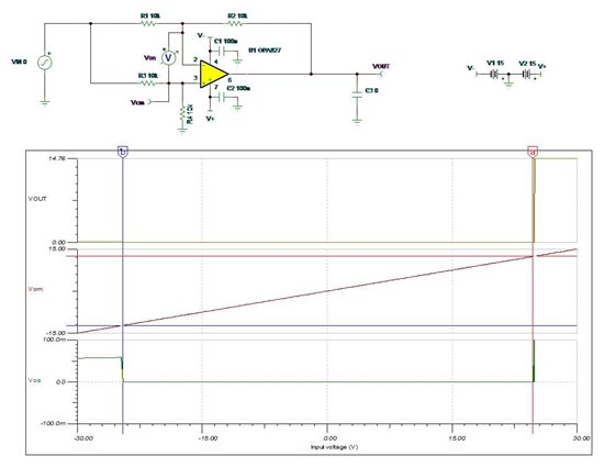

I am using the OPA827 opamps on the front end of a sensor and I see a big (6dB) CMRR difference between amplifiers.
Could you supply me with a CMRR testing circuit so I could select amps before they are installed in our product?
Paul
  • Paul,

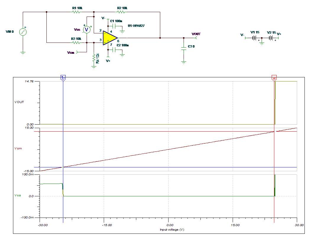

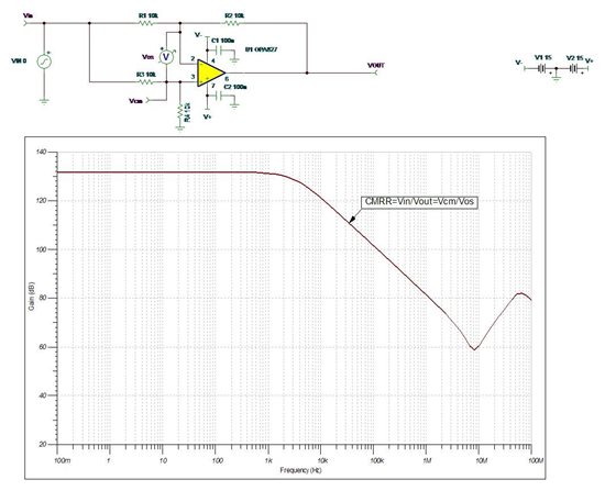

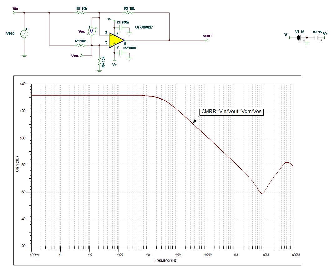

    What amplifiers are you comparing?  Below please see the circuit configuration (difference amplifier) used for testing ac CMRR and common-mode input range.
    I have also attached Tina-TI schematic for you convenience.
    OPA827 AC CMRR
    OPA827 Common-mode Input voltage Range
    OPA827 AC CMRR.TSC
  • Is this circuit actually used to test op-amps and provide the CMRR graphs in their respective datasheets? I have always used a similar circuit, but I include a buffer on the output inside the feedback loop to null out the output impedance of the amplifier I am simulating.
    Also, if CMRR = Vcm/Vos, does this not also include the gain error and not just the CMRR of the amplifier itself?
    -Ken
  • Ken,
    For ac CMRR graph (using a difference amplifier configuration as shown above), CMRR=Vcm/Vos=Vin/Vout  BUT for dc CMRR=(delta_Vcm)/(delta_Vos).
    Using a follower configuration (G=1) to measure CMRR would result in CMRR and comparable AOL (gain) error since AOL=(delta_Vout)/(delta_Vos).  That is the reason for using instead a difference amplifier configuration for measuring CMRR where Vout does NOT move (to the first-order) with Vcm so there is effectively no gain error (Vout=2*Vos).
    If you want to be splitting hairs, however, and assume AOL=120dB and CMRR=120dB (1E6), as you move the Vcm by 10V (using a difference amplifier configuration) Vos changes by ~10uV (10V/1E6) - this in turn would result in Vout change of ~20uV (Vout=2*Vos) which in turn would cause a gain-related Vos error of ~20pV (Vout/AOL=20uV/1E6); but 20pV gain error would result in CMRR: 20*log[10V/(10uV+20pV)]=119.999983dB - the error is well below the noise level of any amplifier.
    Also, since an output impedance of the amplifier influences the actual shape of the CMRR curve over frequency, no output buffer should be used to generate CMRR graphs.
