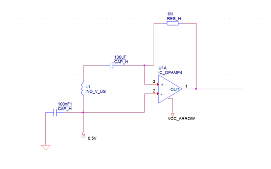

    because my question was not clear I added a drawing.
    this is what I did. whene I connect pulse generator it is working with off set but when I connect a coil (or wire) const off set (instead of 0) in the output why? I wanted to get a reference drawing to how I should have done it because I have very big offset.

    Your diagram is not so clear. It appears that you may be connecting the coil with one connection to the amplifier input and the other to ground. What is the power supply voltage on your amplifier. This circuit will require a positive and negative power supply voltage to operate properly.
    Regards, Bruce.
  • Hi
    I do not need negative output.
    first of all I want this to work only for positive voltage in the coil (negative will result output 0).  after this will work I will connect an offset voltage -1mV to the + and this will be my off set and in that way I will be able to see the so called negative voltage from the coil.
    is it make sense to you?
    The problem is that I cant make it work because the offset voltage if the amp is to big and I cant zero .
    how can I lower this offset (when I connect wire between the + and - I see offset and not 0...)
    thanks in advanced,
  • Without a negative supply voltage, offset voltage and output voltage swing limitations will cause a "dead band" near zero. It will requires some substantial positive input voltage to cause a positive-going output voltage. An alternative is to provide a small positive bias voltage on the low side of your coil--perhaps about 0.1V. If you you need further assistance, please provide a readable schematic showing resistor values and power supply voltage.
    Regards, Bruce

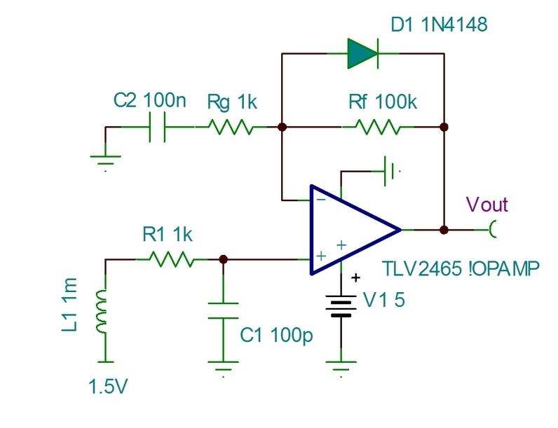

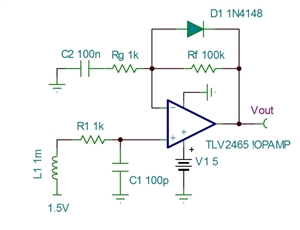

    Here is a possible approach for your circuit:
    C2 reduces the gain to unity (G=1) at DC so that a bias voltage of 1.5V can be used. This biases the output voltage to 1.5V with no signal. D1 clamps the output so that it will not swing fully to ground with negative input voltage. This avoids possible problems with output "sticking" or overload recovery that can occur when the output is driven strongly into the negative rail. Positive-going signals would be amplified by 101.

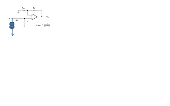

    You did not mention the frequency range of interest. The value of C2 shown would roll off the gain 1.6kHz and below. The value of C2 could be adjusted according to your required frequency range.
    Regards, Bruce.
  • thanks. this completely answers my question.
    I had problem with the vss that was too low and this created the offset I had. after raising it to 3.3V the offset issue was solved. the amp itself have some kind of very small offset that allow me to see "negative" voltages but your solution with C2 it 100% more controllable and I will do it like you advised the problem is that I belive that because my freq in the voltage coil is low (around 5-10HZ) the C2 will also reduce those low freq signals (low impedance) so I will use bigger capacitor.
    I think you have a small mistake because the LPF you design is for 1.6MHz not Khz (1/1K*100P*2*pi=1.6Mhz) I did it yesterday with 100nF and 10Kohm and it added noise more than it filtered. still dont know why...

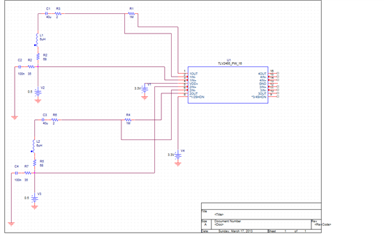

  • hi
    attached is the updated circuit sketch:
    I also added next to each coil and capacitor it resistance - I believe that in the last message I wrote something wrong that this is working because the capacitor impedance but this is probably working because of the coil resistance - R2.
    the questions are:
    1.in this circuit where I dont want the coils to have mutual ground, is it OK to connect the coils in that way.
     2. I see bias of 0.2 between out 1 and out 2. why is this happening and how can I fix it?
  • hi
    in that circuit the coils are the sensors and they experience signals 0.2mV in freq 5-20Hz.
    the questions are:
    thanks,

  • or sam,
    Sorry, but I have not been able to make much sense of your circuit diagram. I will refer only to the lower circuit. The upper circuit has two resistors designated R2 which could be be confusing.
    C4 and R7 seem to provide no function in the circuit as they are connected to what appears to a low impedance 0.5V source. Did you imagine that they are setting gain? They are not.
    R6 and R7 combine to effectively make a 70 ohm resistor. Is R7 attempting to model coil resistance?
    This is connected as an inverting amplifier. R4 is the feedback resistor. The impedance that sets the gain is the combined impedance of coil, C3, R6 and R7. The reactance of the 5uH coil is virtually zero at 20Hz and lower. The reactance of C3 is about 200 ohms at 20Hz. So the inverting gain is about 1M/212 =4700. The gain would be reduced at lower frequency as the reactance of C3 increases.
    The output voltage should be centered near 0.5V, nearly equal on both channels. It you are seeing a significant difference between the two channels, it is probably due to leakage of the 40uF capacitors. If you disconnect the series connection of the coil, C3, R6 and R7, you should see the output voltage go to 0.5V. Since the capacitor should be an open circuit at DC, this would prove that its leakage is causing any large offsets.
    The input bias current of the TLV2465 may be causing some offset--perhaps 10mV or so. This could be reduced by changing to a CMOS-input op amp.
    It is not clear why you do not want the coils to share a mutual ground. They now share a mutual 0.5V source, each through a 68 ohm resistor.
    Regards, Bruce
