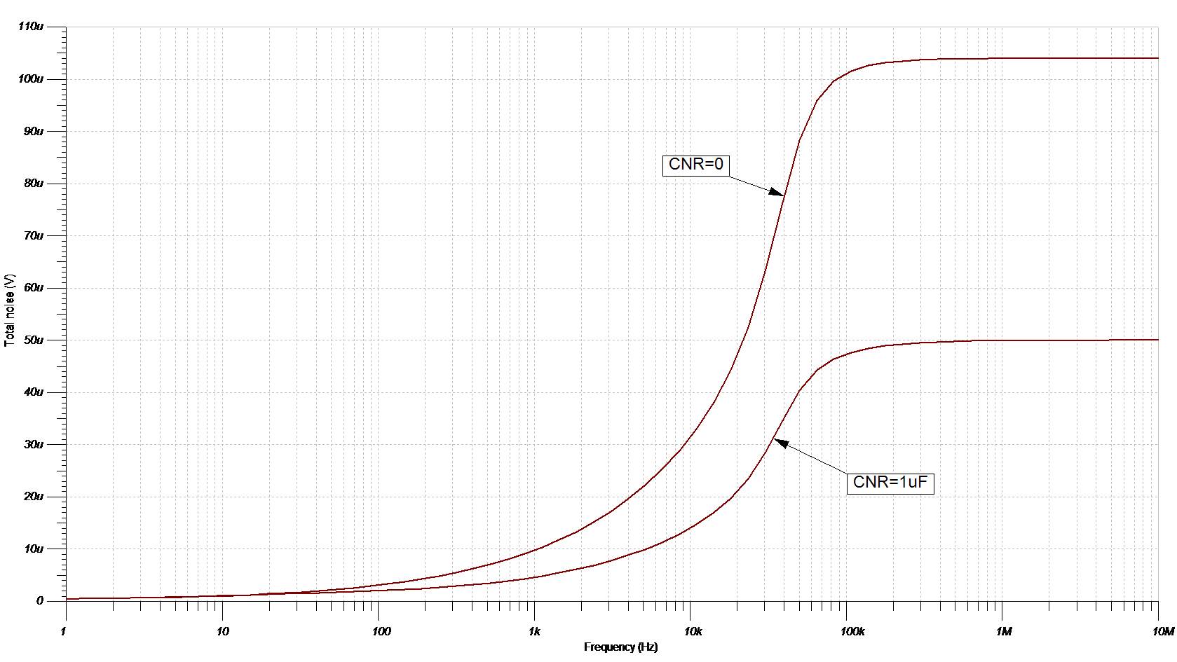

We are planning to use REF5020 as a reference input to characterize CT front end device for which integrated noise is a very critical spec. So we want to know REF5020 integrated noise till say 10M. I simulated REF5020 model using TINA and found it reaches to 33uV as shown in below plot which seems to be quite high. So I was wondering whether noise has been modeled correctly or not. So could any one have idea about integrated noise of REF5020 till 10MHz?

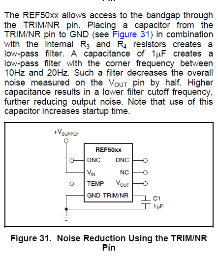

    First, the noise performance of REF5020 is a function of a capacitor placed on TRIM/NR pin (see below) where adding 1uF capacitor decreases the overall output noise by a factor of 2.  Also, adding RC filtering at the output with corner frequency below ~60kHz will decrease the total noise-see voltage noise spectral density simulation plots below.  The REF5020 macro-model provided on TI website may not be precise but is relatively close to correctly simulate the output voltage noise.
    I have simulated the REF5020 output voltage noise spectral density with CNR of 0 and 1uF - see results below;
    The integrated noise for the two cases is shown below: ~105uV for CNR=0 and ~50uV for CNR=1uF.
    Of course, the simulations above do NOT include the effects of any additional RC filtering at the REF5020 output and thus any such additional pole below ~60kHz will result in a decrease of the total noise of REF5020.

    Thanks for your quick reply. It seems TINA model and your simulation results matches very nearly. Initially we were avoiding putting any filter at the reference output because our device takes some current from reference and because of which putting resistance in the path will introduce some drop in the reference and will result in some error. But it seems we have to put external filter to avoid noise. We will analyze it more and will see possibility of putting any buffer which will provide device current.
