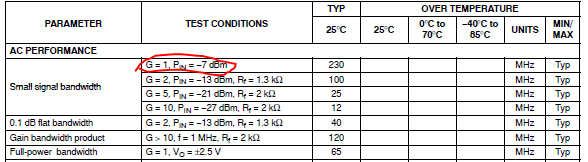

Hi TI technical Support,
Please find the figure below.
Here i am confusing with first parameter.
In small signal bandwidth: test conditions it is showing that G=1,Pin = -7dBm. what is this mean exactly?
Is this gain tested with respect to input power.What is this parameter exactly mean"G=1,Pin = -7dBm".
Here my input parameters to OPAMP:
signal - Square wave , 4V peak-peak
1pF only can drive to OPAMP.
Frequency: 40MHz - 100MHz
-3db cuf off frequency - 200MHz.
I want to operate this op amp as unity gain buffer.
Thank You in advance.
