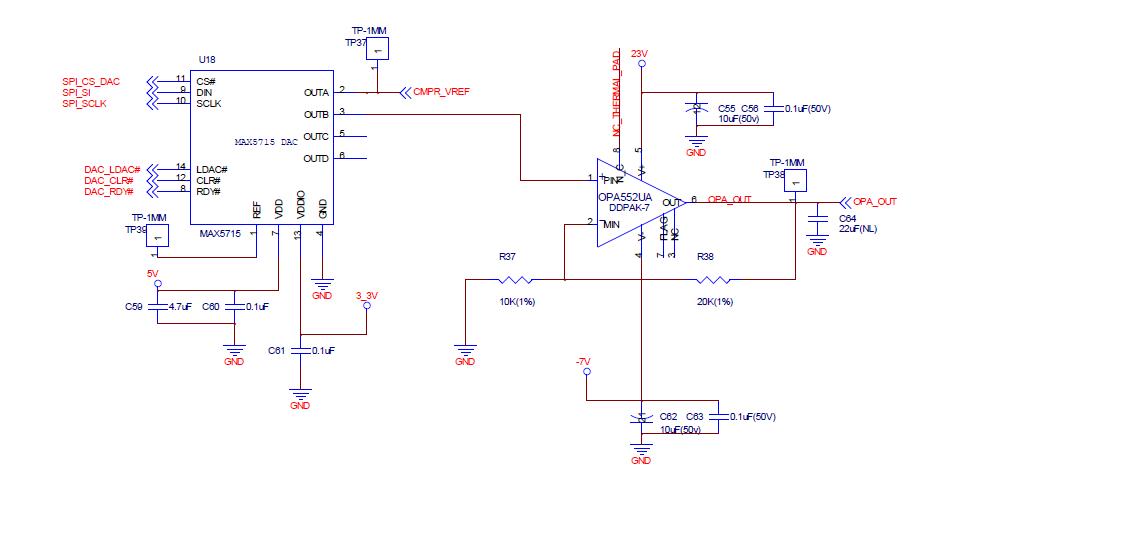

I have some OP amp stabilize issues in my design. I use DAC and OP amp in my system. And OP amp with a 22uF ceramic cap.
I use this op amp as non-inverting amplifier. And the schematic as attached pic. I found that Vout is oscillate and the current consume by OPA552 was very high(abt. 150mA).
I know that I can use OPA552 as Gain<5. Does this issues being solved if I change my op to OPA551? Or how do I stabilize this circuit? Thanks!
  • Dear all:
    If I can't change my design to OPA551. But I can change R38 to 40K ohm. let Acl = 5. How do I compensate this circuit if I still use OPA552. and Acl = 5. with 22uF cap load.

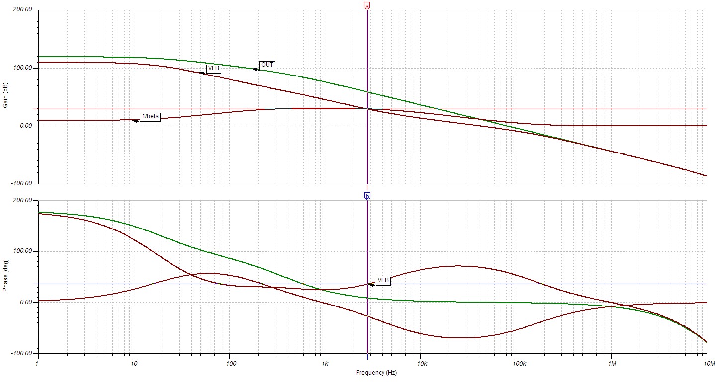

  • In general for Gains less than 5 use the OPA551 which is unity gain stable.  Due to your cap load and the new recommended compensation you can use OPA552.  See attached for new compensation for stability.  Inside the PowerPoint are embedded TINA SPICE files you can open and run with TI free SPICE simulator by link included in attached.  In addition I reference in attached an op amp stability article series that will give you all of the theory and techniques you need to understand this problem and future ones.

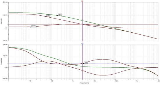

    1.I'm a little confused about that the attached TSC file in your ppt page 6. I open this TSC file but there is no 22uF C-load and the Cf was replaced by 1nF; Rn replace by 634 ohm(compare to picture on page 6). And I try to fix this design to Cf = 100pF, Rn = 6.34k and add a 22uF C-load. is that right?
    2. I just wondering if I change my design to OPA551.Dose the compensation need to be modified or not?

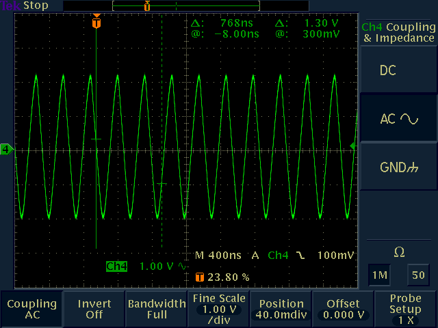

    3. And I use TINA to simulate compensate just only Cf(because the PCB can't be modified as soon). The plot looks good and stable. But I add Cf(172pf) to my board in real world. The output of OPA still oscillate 172Khz and about 50mV. And It still consume about 150mA. Is that means I still have to add Rn Cn to my board? If it is true, why TINA simulation shows that will stable by just add Cf(172pF)? Thanks for kindly help.
    the attaches are the simulated result.0333.opa552_Cf.zip
  • See attached revised analysis for clarity and corrections. Sorry for the second pass as  I made a couple of mistakes.  In attached you will see a Loop Gain analysis of your experiment with the 172pF which shows loop gain phase dipping near zero and only 28 degrees of phase margin.  Your real world parts are probably not exactly the values you show in TINA so phase margin is probably less. Real world Aol will have variance from part to part as well.  Make sure you have 0.1uF bypass capacitors right at pins of OPA552 and within less than 1 inch at least 10uF of capacitance on each supply.   On any PCB you should be able to solder in recommended compensation parts on top of existing pads.  Note you will need to change feedback and input resistor values to 200k and 100k as shown in attached. If you change parts to OPA551 you will need to re-compensate with different values for stability.  You should consider soldering in recommended values in attached on your current PCB and check in lab.

    I have a other question. Is the phase margin of the system defined by a. Aol intersect 1/beta or b. Vfb intersect 0db?
    I have seen so many definitions and the solutions you provide is Vfb intersect 0db. If I use Vfb intersect 1/beta. The phase margin of the system is 36 degree only.
    What's the difference between these definitions? Thanks.
  • You will find in the article series that the intersection of 1/Beta and Aol (what I call fcl)  is where loop gain goes to zero and the phase margin is looked at.  You can only look at phase margin by doing a loop gain plot.. Any relative phase of Aol or 1/Beta by themselves is meaningless for stability analysis.  To produce a loop gain plot one must break the closed loop open for AC loop gain analysis. This is why I use large inductor to keep loop closed at DC so SPICE can find a DC operating point before it can run an AC Analysis.  At any frequency of interest the inductor will look like an open.  Large cap couples in test signal since it is open for DC and short for any AC frequency of interest.

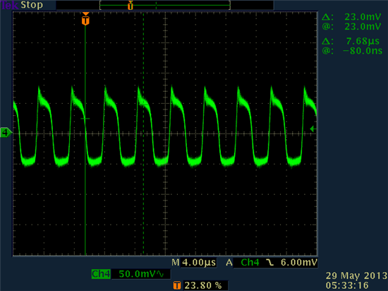

  • Dear Tim:

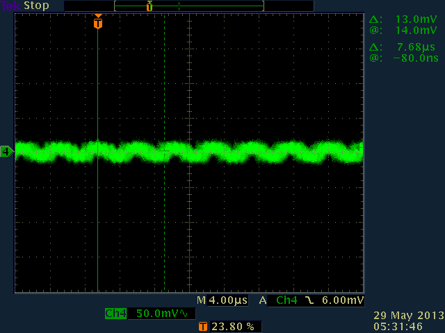

    I modified my board to adding the compensation circuit Cf, Cn and Rn。
    And the output of the OPA552 seems stable.
    But It still consumes 110mA on 23V and -7V power source. And the OPA became very hot.
    And I measure the AC mode of the output as follows.
    And about +-15mV ripple still here@240kHz. I think that the reason why the OPA552 still consumes powers by charge and discharge C-load.
    I don't know the OPA is in stable or unstable state. If it's stable. Is that means I can only use the OPA552 with C-load and consumes such big power?
    Thanks for the kindly help!
  • We need to do some troubleshooting to discover the root cause of your high current draw.  With the sawtooth waveform you measure at 250kHz and 30mVpp ripple you can be consuming power.  Since Cload=22uF its impedance at 250kHz = 0.03ohms.  This voltage waveform on the output can cause high Iq.

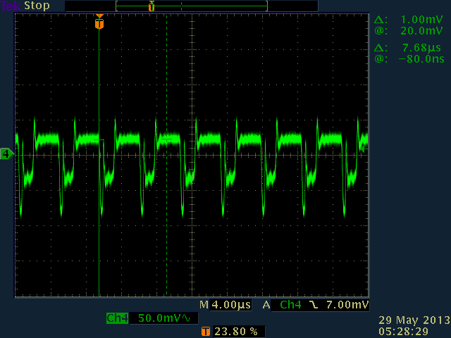

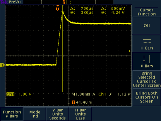

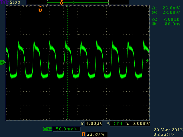

  • 1) What power supplies are being used? Check power supply at op amp for ripple amplitude and frequency if any.  If power supply is a switching power supply the PSRR of OPA552 can allow power supply ripple across large cap load (22uF) causing high Iq.
    There is really ripples at V+ and V-of OPA552. the V+ 23V plot as follows.
    And the very source of my power supply 23V is as phots.
    OPA -7 at OPA V-
    I'm using Programmable Linear DC Power Supplies and If there is no load for OPA. There is not ripples here.
    2) Remove 22uF capacitor and see if power supply ripple and amplitude changes.
    Yes there is still ripple if I remove C-load. and the amplitude of the ripple as photo.
    But there is not any ripple at 23V V+ and -7V -V at OPA552 pad. And of course There is no big current like before.
    And I found that, if there is no big current on the load, there is no ripple at power source.

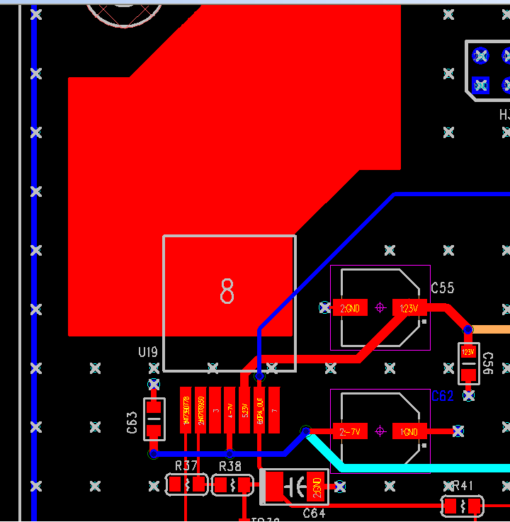

    3) Does your PCB have both low frequency (10uF cap) and high frequency bypass (0.1uF cap) right at OPA552?
    Yes. But the layout may be too far to the OPA. Please see attached layout photo.

    I think the suspect may be the de-couple cap. Here's the layout of my experimental board.
    The high freq. cap is too far for OPA552. But I'm not sure if it is the root cause of the problem I met.

  • From your last post:
    6) Copper area DD-PAK tab is soldered to is not connected to anything - correct?
    2) Removing Cload of 22uF will make OPA552 unstable since it was compensated only with 22uF present.
    I do have concerns about the routing of the high frequency bypass.  I will attach a recommended experiment to help get the high frequency bypass connected correctly.
