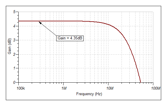

    If you want the output to be biased to mid-supply for maximum swing, then you should bias the non-inverting input to [2.5V-(4.238V*-1.65)]/2.65 = 3.582V. This sets the output DC operating point to mid-supply and the AC gain to the expected -1.65V/V or 4.35dB.
    However, this will only work for small AC signals because the input DC operating point is now high. The max signal the amp can handle is about 2.7Vpp around a 4.238V DC offset.

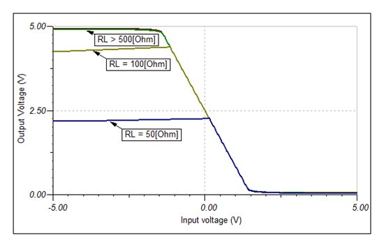

    Regarding the original question, the OPA836 can indeed swing from 0.2V to 4.75V for a load of 1kΩ. However, as you start to decrease the load, the swing capability will also decrease. This is also apparent in the SPICE model, but the actual values may not be modeled correctly.
    I've included the simulation file below to show a sample biasing scheme to get maximum output swing at -1.65V/V gain without violating the input common mode range spec either.
    That is understandable of course. I was just concerned I was misunderstanding something fundamental about the OPA836, but I think from your reply it's not the case.

    So, just to be sure, the output swing can be same as specifications show (for gain of +5) in a gain of -1 application, right? Because there obviously the input common mode range is not an issue (as long as it is in 0 to 3.8V w/ 5V supply I mean).
    Yes. Assuming the output is biased to midsupply (or 2.475 to be exact) and you aren't violating the input common mode range you can get the full swing.
