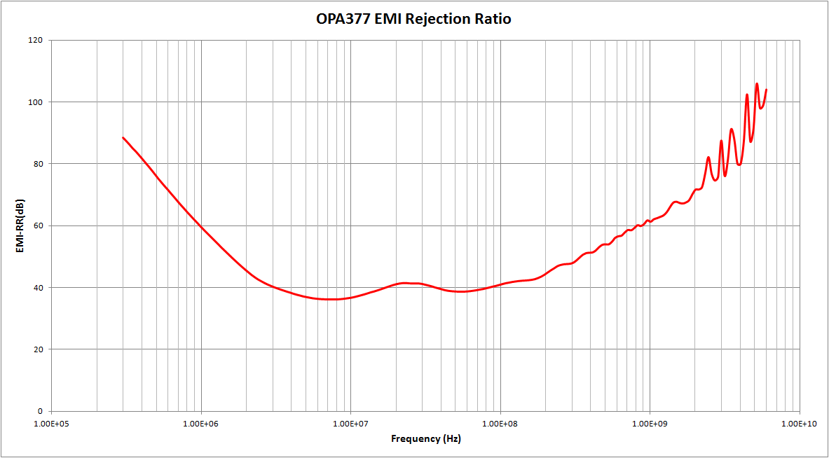

Is the same EMIRR(EMI rejection ratio) test that is done on the OPA188 performed on the OPA377 also?
  • Yes! The EMIRR of the OPA377 has been previously measured:
    We're working to generate reports of these results for parts in our catalog that do not include the EMIRR curve in the datasheet. An example of one of these reports can be seen on the OPA333 product page, there is a link to the report below the datasheet.  A test report for the OPA377 should be created sometime in the near future.
