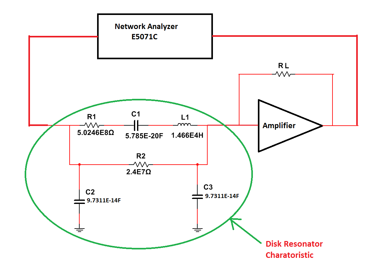

I have a self-design Radial Disk Resonator. Now I would like to measure its Resonant Frequency. As my calculation, Disk Resonator has resonant frequency at 8MHz. I would like to add transresistance Amplifier that linear stable from 5MHz to 40Mz to detect the resonant frequency phenomena. Please help me choose one Amplifier and circuit diagram connection to my Disk Resonator. I am using Network analyzer E5071C to detect the resonant frequency.
I am really need your help, my major is mechanical so I have very little knowledge on electronics device.
Thank you very much!
