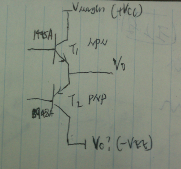

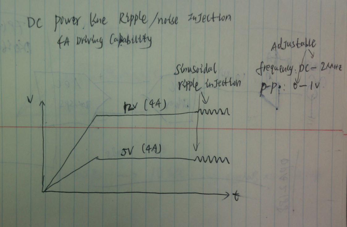

I encounter a technical difficulty on how to inject sinusoidal ripple/noise into DC power line. The design requirement is let's say I have 12V DC or 5V DC power line, each power line has 4A driving capability. I need to inject sinusoidal waveform with adjustable frequency and peak to peak voltage into these 12V and 5V power line to simulation power line ripple/noise situation.  Sinusoidal waveform can be easily derived from DDS (Digital Signal Synthesizer), but signal output from DDS is relative low in power and voltage level. How to inject such Sinusoidal waveform into power line is big challenge to me. Some people says maybe I can use PNP and NPN Power Transistor pair to build a power amplifier but I am not sure how to properly use discrete transistors to build such power amplifier.
Any body has experience or idea on how to do this? Thanks. Please refer to below picture for illustration on what I am trying to do (I hand drawing on a paper).
Ripple/Noise Injection illustration
PNP NPN pair amplifier

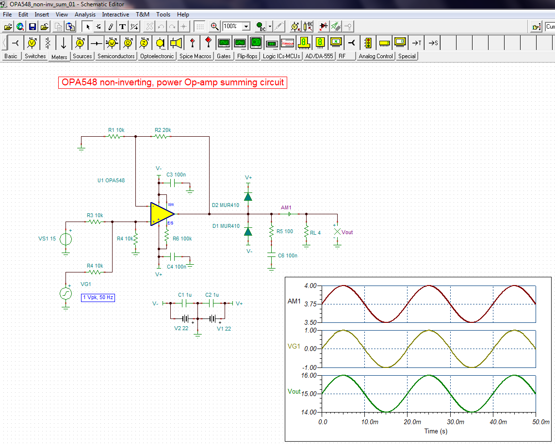

    You could use a power operational amplifier as a non-inverting summing amplifier. You would sum the dc level with the ac ripple you wish to impose on the dc line. You can see the general principle illustrated in the attached schematic diagram using the OPA548.
    Finding a power operational amplifier that can provide the 4 Ampere nominal dc level, plus the ac ripple current up to 2 MHz is a challenge. Our OPA548 can be used in this manner, but it doesn't have enough bandwidth to support the 2 MHz ac ripple need. There may be another power operational amplifier by another manufacturer that does meet both the current and bandwidth requirements. You may want to check on line and see if there is amplifier that would meet all your requirements.
    You show a simplified complementary NPN/PNP output stage that at one time was common in operational amplifiers. It is conceivable that you could team a pair of complementary high-speed (RF) power transistors with a high-speed operational amplifier and get the current and bandwidth you need. The transistors would follow the operational amplifier output and the emitters would feed back to the inverting input. Some form of dc bias would be needed to bring the transistors into class AB operation and very likely the entire amplifier would require compensation to keep it stable. This approach would require a lot of design effort.

    This for the detailed explanation, that's really helpful. BTW, May I know what's the simulation software you using in attached pic? Thanks.
    Wang Xiao
  • Hi Xiao,
    The OPA548 summing circuit was simulated using TI's free, TINA-TI Spice simulation software. It is very easy to learn and will allow you to create and simulate your own circuits. Here is the link where you can download the TINA-TI:
    http://www.ti.com/tool/tina-ti&DCMP=hpa_amp_general&HQS=Other+OT+tina-ti
    I also have attached my original OPA548 simulation circuit so you can evaluate the summing amplifier idea.
    Regards, Thomas
    PA - Linear Applications Engineering
    OPA548_non-inv_sum_01.TSC

    May I know how did you observer AM1 and Vout together, I can only observer voltage by oscilloscope.
    By the way, I used Tina-TI.
    Thank you.
  • Hi Hamilton,
    I understand your question to mean AM1 and Vout in the TINA simulation results I had posted. AM1 is one of TINA's types of ammeters. It appears as a horizontal line with an arrowhead pointing to the right. TINA refers to it as the "current arrow" and it is listed within TINA's "Meters" pull-down. I use the "open circuit" symbol in the "Meters" pull-down for the voltage measurement.
    When both of these meters are used in the circuit TINA will show their measurement results whenever you perform an dc, ac, or transient analysis.
    Regards, Thomas
  • Hi Thomas.
    That's very kind of you, after your explanation, I used transient analysis to get the AM1 value I want.
