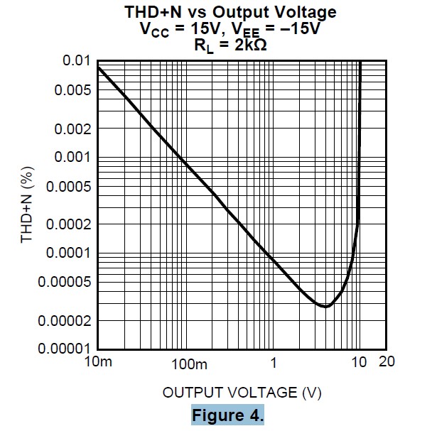

    As an example, please look at LM4562 official datasheet (High-Fidelity Audio Operational Amplifier).
    On the page 6 – figure 4 and on the page 9 – figure 25 for instance.
    So, THD and IMD are more than dramatically increased (!) with low fundamental signal amplitude for LM4562. And I can suppose that relative total distortion level is increased due to higher order harmonics enlargement. And higher order odd harmonics serve as a killer for sound, as all we know.

    Regarding your comments on low power distortion getting worse based on the LM4562 Figure 4 and Figure 25:
    These plots at “low x-axis (output voltage)” are mostly a measure of the output RMS noise (not distortion). In this low output power region, where the plot is a straight line, as you lower power level there is a fixed amount of output noise such that the y-axis increases (divide a constant by a smaller number) since this noise power is a bigger percentage of the fundamental power. The rise is not indicative of higher distortion but a constant noise power with ever decreasing fundamental power. So, I don’t agree with your assessment that THD (dBc) gets worse at lower power. It is noise that dominates at the lower power levels.
