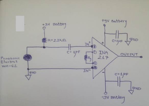

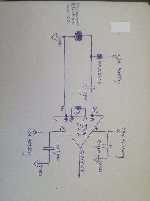

I'm using the schematics below to connect my electret mic to a Texas Instruments INA217 Instrumentation amplifier:

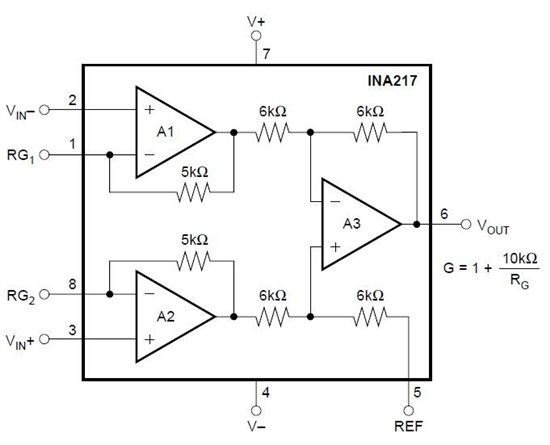

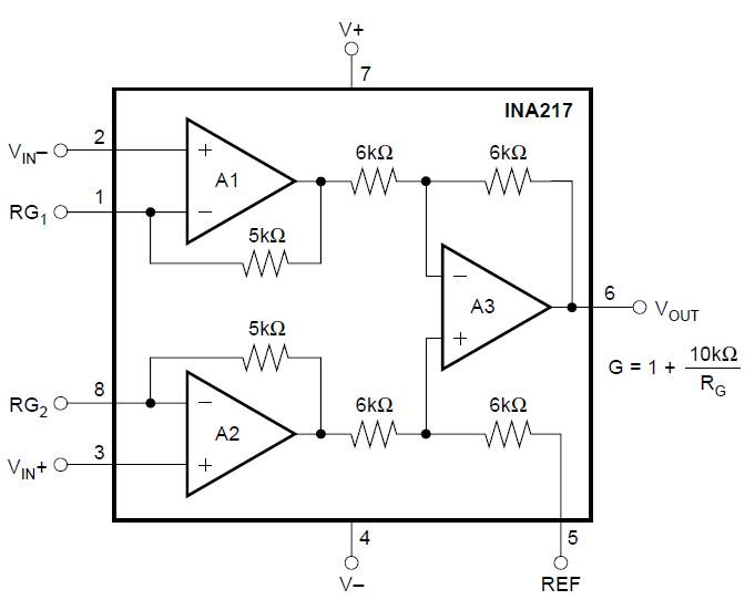

The gain equation for this amplifier is : GAIN = 1 + 10,000/Rg, where Rg is the value of the resistor between pins 1 & 8.
I tried to use all sorts of values for the gain. Theoretical gains of 50,100,200 all gave me a smaller peak to peak voltage while recording( attenuation! ).
I didn't have these problems when I connected the mic with a simple operational amplifier like the Texas Instruments TL071. With the
TL071 I recieved very large gains at the output and it was very clean and good.

1)What do you think is the problem with this circuit?
2)In general, are the bypass capacitor values O.K for frequencies as low as 4kHz? Should I use larger capacitance capacitors?
  • David,

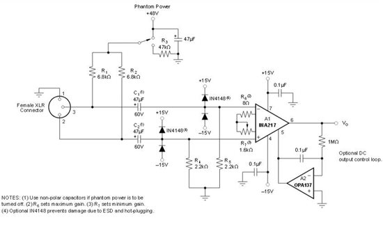

    INA217 requires a DC input bias current of up to 12uA for proper operation (see PDS table below) that is NOT possible with your circuit configuration.

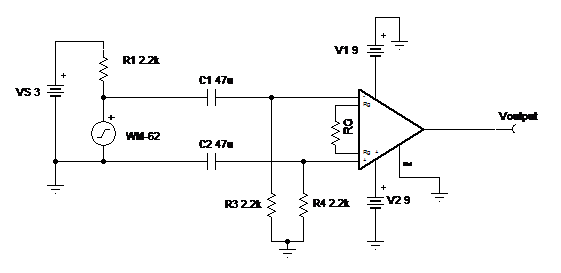

    Your input terminal, IN+, is AC coupled with C=1uF capacitor instead of being DC biased-this does NOT allow a DC bias current necessary for proper operation of the bipolar input transistor; in other words, R=2.2k resistor MUST be directly at the input of OPA217 (to the right instead of to the left of your 1uF capacitor) - see PDS application schematic below.
    Also, make sure to bias both inputs at the same DC level.  Since you use dual supply, +/-9V, most likely both inputs should be biased at 0V with a use of two resistors (R4 and R5) as shown in the schematic below; biasing IN+ at 3V while IN- at 0V with a close-loop gain of 3 or greater would result in the output collapsing on one of its rails.

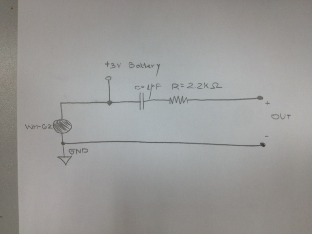

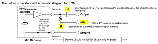

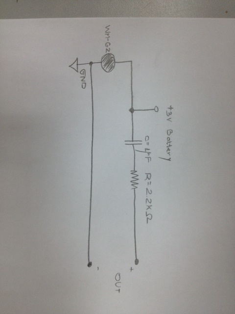

    1)In Panasonic's PDF about electret mic's, the schematics is:
    You suggested putting the R=2.2k ti the right of the C=1uF. Did you mean I have to replace the existing R=2.2k? Or should I just put an additional R=2.2k to the right?
    The Panasonic's schematic above is highly simplified and does NOT provide the biasing details necessary for proper operation of any instrumentation amplifier.
    The R=2.2k resistor at the input of your circuit (see below) does NOT do anything other than loading WM-62 signal source so it should be eliminated and replaced with the resistor right at the IN+ input.

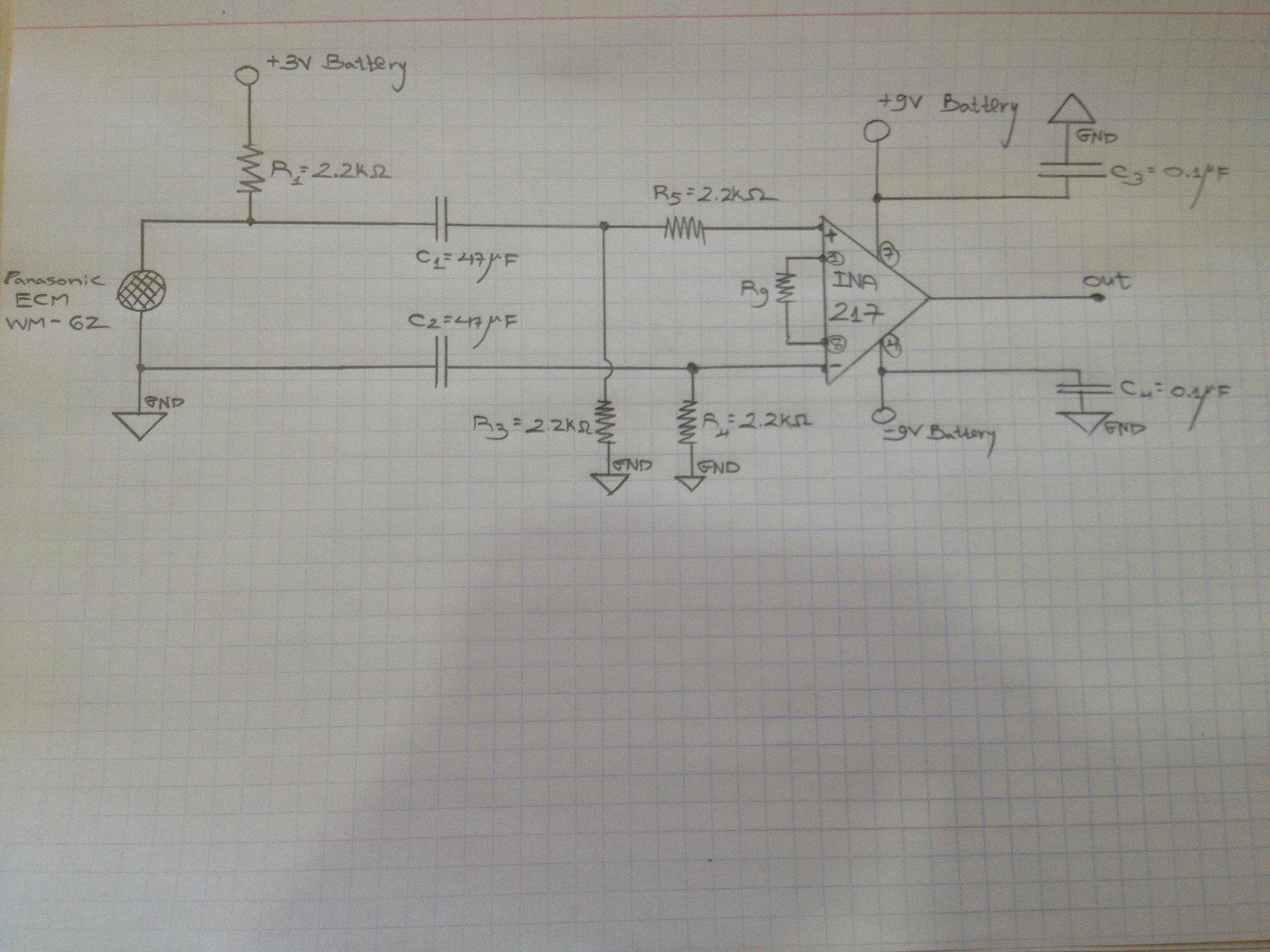

  • First of all, thank you for your answer.

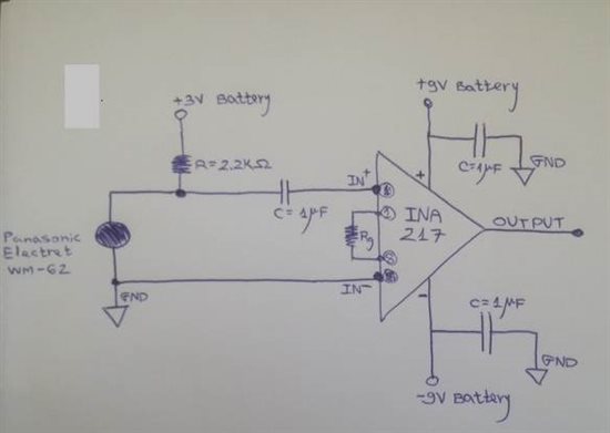

    I'm having problems with leaving the R=2.2k out of the path from the 3V battery to the mic.
    The schematics now is:
    When I measure the output voltage, all I see is noise. The mic isn't responding.
    What is the cause?
    David.

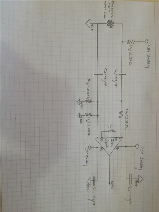

  • I've connected the following circuit and it simply doesn't work:
    I also see strange oscillations at the output.
  • David,
    First, in order for your circuit to work you may NOT float REF pin 5 - see below.
    REF pin must be connected preferably to GND (see below) - I do not see it at all on your schematic.
    Also, there is no need for R5 resistor shown in your circuit - it only increases the input voltage offset between the input terminals.
  • Thank you for your replies, Marek.
    I've managed to make the circuit work after your advice.
    The circuit is now:
    The circuit works with all kinds of values for Rg and gains.
    But I still have 2 problems:
    1. I have a voltage offset of minus 5mV at the input, when the INA217 is connected to power. This of course corresponds to a greater voltage offset at the output (offset input*gain)
    2.Every time I connect the 0.1uF capacitors from the power sources to ground, The INA217 begins to oscillate and heat up very rapidly.
