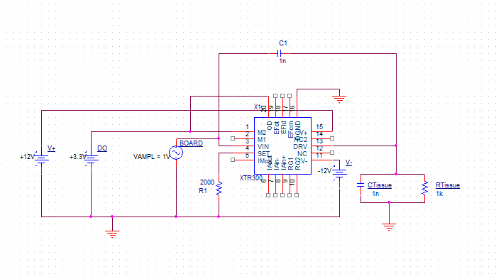

I am trying to use the XTR300 as a constant current source in order to measure impedance across tissue using a 1V p-p sine wave as the input.  The circuit diagram can be found below. However, when measuring the voltage across the tissue, unplugging the leads (creating an open circuit from DRV to ground) results in the presence of a constant AC voltage. Shouldn't this value be zero, because no current should be flowing? What could be possible causes for this?

    We tested your circuit in the lab today and did not observe the same results you have.  Would you please attach a scope shot with the problem waveform?

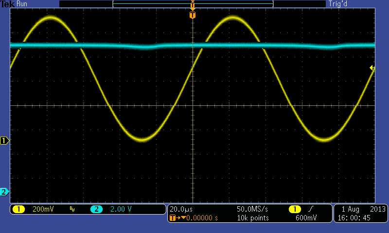

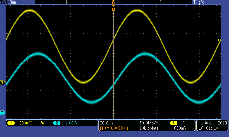

    1.)  Normal operation:

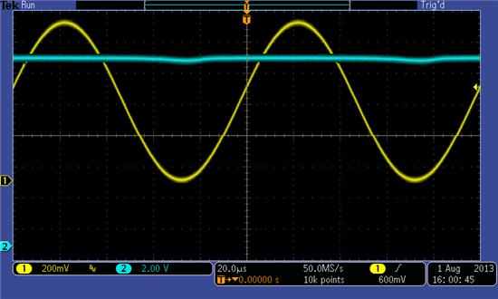

    2.)  Without 1kOhm, with 1nF

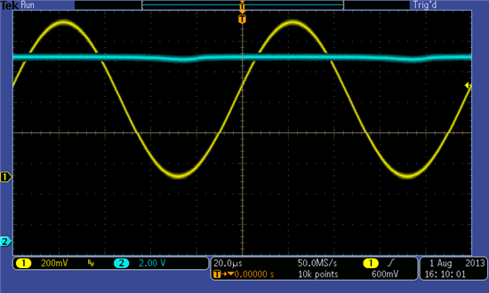

    3.)  Without either

    This is the expected application for a current source.  The output voltage of a current source with a ground-referenced load is Vout = Iout *Rload.  If the load resistor is removed, Rload in the equation is basically infinite.  Therefore, Vout will go as high as it can which is limited to the positive rail.
    A current-sink will do just the opposite and will pull to the negative rail for an open circuit.
