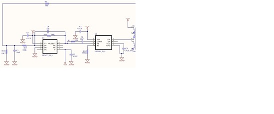

for my project am using OPA277 as a unity gain inverting amplifier with +/-12 supply, my problem is am getting 1.556V at output when my input is only -0.278V, Please any one help me to solve this issue, Please find the attached my schematic

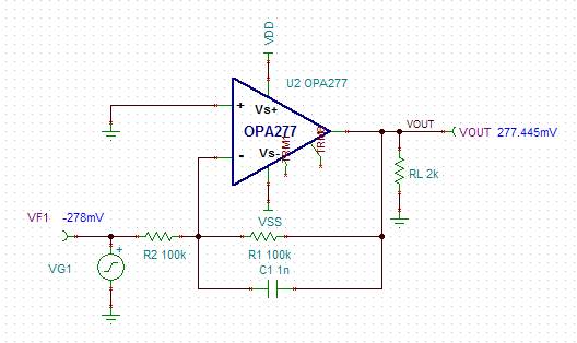

Saravanakumar,
You do not show the entire application but as far as OPA277 is concerned, the circuit should work just fine - see simulation below. Do you measure 1.556V with a multimeter at the output (pin 6) of OPA277? If so, perhaps you should use a scope to probe various nodes to make sure there is no oscillation.
Marek,
Thanks for your replay,
actually, after i removed the "C1" this start working properly, am not very sure what could be the reason,
