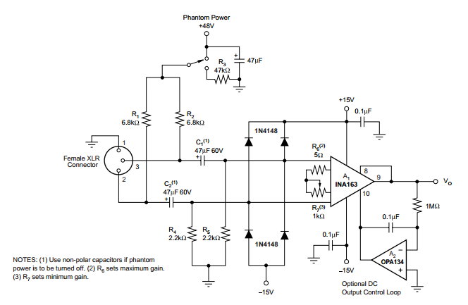

I would like to inquire regarding a microphone preamplifier that is compatible with low frequency (1Hz) as well as standard audio up to 20kHz. Also important low noise, low THD.
I would like to ask what is the recommended model for a chip as well as evaluation board.

  • Shelly,
    This is not the correct forum for audio ADCs and DACs. However, the amplifiers that are specifically intended for microphone pre-amplifier use are the: INA217, INA163, INA166, and the older INA103. The typical microphone pre-amplifier circuit is shown below:
    You would need to increase the values of the AC coupling capacitors C1 and C2 as well as the input resistors R4 and R5 to achieve the necessary low-frequency corner.
