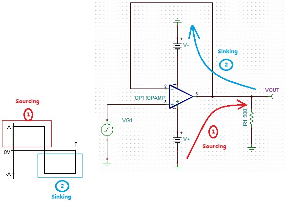

       So if it is PWM input to a follower as below.
       Assuming |V+| ≠ |V-|
       The PD= (|V+| + |V-|)*IQ + [(V+) - A]*(500/A)  + [-A - (V-)]*(500/A)   , right?
  • Hi Mister,
    The instantaneous power will be:
    A = Vout amplitude
    P_inst_pos = (V+ - V-) * IQ + (V+ - A) * (A / 500ohm)               For the positive cycle
    P_inst_neg = (V+ - V-) * IQ + (-A - V-) * (A / 500ohm)               For the negative cycle
    To get the average power dissipation, integrate the expressions above over the PWM active time for each cycle and divide by the period.
    For example, assume:
    V+= 5V
    V-= -4V
    A= 2V
    IQ= 2mA
    PWM duty cycle = 30%
    Then:
    P_pos_cycle = (5 - (-4)) * 2mA +(5 - 2) * (2/ 500ohm) * 0.3 = 18mW + 12mW * 0.3 = 21.6mW
    P_neg_cycle = (5 - (-4)) * 2mA + (-2 - (-4)) * (2 / 500ohm) * 0.7= 18mW + 8mW * 0.7= 23.6mW
    P_average = (21.6mW + 23.6mW) /2 = 22.6mW

  • Hello Mister,
    1. 0.3 and 0.7 justification: Those are percentages (30% and 70%). The period / frequency is irrelevant. Only duty cycle matters.
    2. Averaging (divide by 2): So, I'm just taking the average of two numbers (which involves adding them together and then dividing the result by 2). It is not the period of the waveform.
    Hooman
