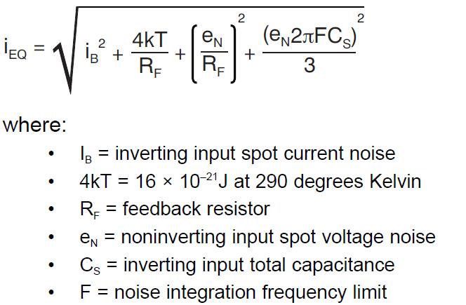

    The un-averaged waveform "noise" riding your sine wave looks a bit non-random (periodic) with about a 0.4 division repetition rate (~50MHz). A spectrum analyzer would probably be a better instrument here to see if you have any spurs there or not? A spectrum analyzer capture would also confirm whether you are dealing with a periodic spur or a random phenomenon.
    If you are dealing with random noise, below is the expected output noise for your conditions:
    The expected input referred current noise can be shown from Eq. 13 from:
    http://www.ti.com/lit/an/sboa122/sboa122.pdf
    The last term derivation (if you are curious) can be found here:
    http://e2e.ti.com/support/amplifiers/high_speed_amplifiers/f/10/p/257049/899977.aspx#899977
    For the OPA657:
    en= 4.8nV/RtHz
    iB= 1.3fA/Rthz (negligible)
    Cs= 22pF + 5pF parasitics= 27pF
    RF= 10k
    4kT= 1.6E-21J at room temp.
    F= assume 10MHz (10k and 1pF result in 16MHz bandwidth)
    iEQ= SQRT( (15fA)^2 + (1.6E-21/ 10k) + (4.8nV/10k)^2 + (4.8nV*2*pi()*10E6* 27pF)^2/3) = SQRT(0 + 160E-27 + 230E-27 + 22.1E-24) = 4.74pA/RtHz (this is dominated by the last term!)
    So, the RMS output noise will be:
    Vo_noise_RMS= 4.74pA/RtHz * 10k * sqrt (10MHz * pi()/2) = 188uA_RMS
    With the scope vertical scale you have shown (50mV/div), this RMS noise (or 1.2mVpp) will probably not be visible! So, I do recommend you look at your closed loop response (possibly using the current source technique I sent earlier) to make sure you're not dealing with lack of phase margin which could result in small amplitude oscillation resembing noise on your waveform.

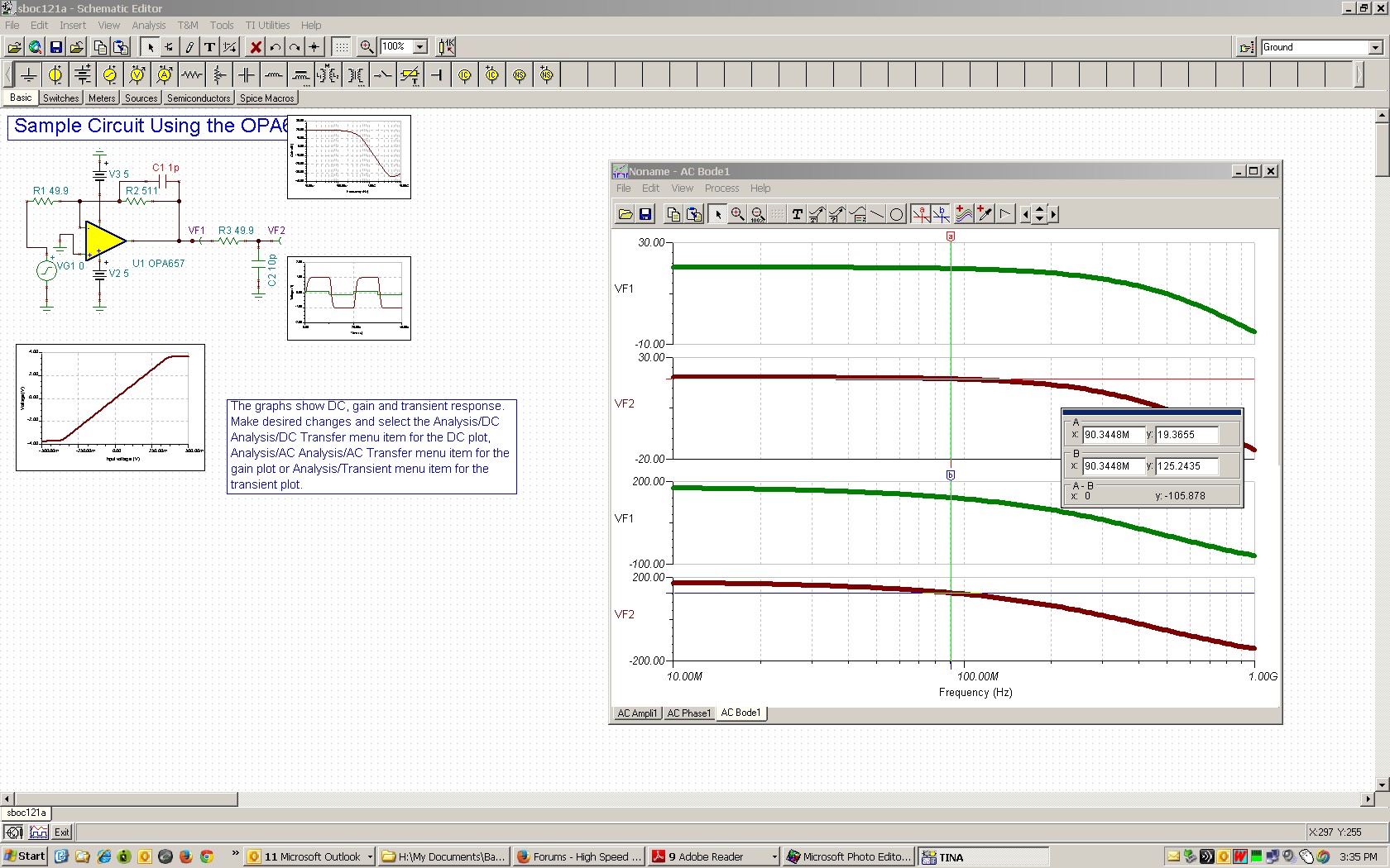

  • Hi Feixiao,
    I bread-boarded the OPA657 as a transimpedance amplifier (gain = 22kV/A) and tested it with a bench generator and I got good results + no instability.
    Here is the TINA-TI circuit which simulates closely with the measured results:
    5432.OPA657 TIA Circuit Bench Testing 10_21_13.TSC
    Here is the resulting step response showing a rise / fall time of close to 31ns (about 10MHz -3dB BW).
    If I were using an actual photodiode as the source, I might have gotten closer to the ~50MHz ~30MHz bandwidth which is what you'd expect (RF= 22k, Cj= 10pF). As you can see, I've used a large cap for C3 (6.8nF) across the input termination to compensate for the parastic cap of the 510k resistor (R4) I've used on the input to mimic a current source.
    Most importantly, I don't see any ringing or oscillation.
    I used the OPA657 EVAL unpoppulated EVAL board for my bench testing:
    http://www.ti.com/tool/dem-opa-sot-1a
    Please review and let me know if you have any questions?
    Hooman
