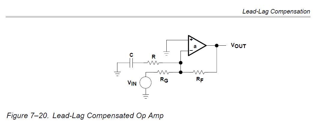

Hi, I have a sensor and I want to use LM7171 in a circuit shown below installed on a bread board for the input frequency of 5MHz. Simplified version of the sensor is a resistance (5Mohm) and a capacitance (2pF) parallel to each other. The sensor is connected to bread board using two BNC cables. The output of the circuit goes to oscilloscope using  BNC cables. When I use the arrangement shown below I get the voltage output of 20V (20MHz)(for +-15 volt power supply) and I do not know where this voltage comes from. When I move the input BNC cables the level of the voltage changes. I would appreciate any help to solve this issue.

    If possible move the sensor as close as possible to the inverting input (any capacitance on this node (i.e. your coax cables), causes unwanted phase shift / phase margin loss. If you cannot move the sensor as described, at least isolate the cables from the inverting input using a small form factor resistor placed close to the inverting input. Shorter cables also help.
    Probing the output directly with a 12pF scope probe is also something to avoid, if you can. An isolation resistor (or a 50ohm series output resistor leading to the scope 50ohm termination) is another method that avoids loading this high speed amplifier with capacitance.
    The non-inverting input 1k resistance adds noise and could possibly affect stability. If the steps above don't resolve your issue, touch a scope probe to the non-inverting input (while monitoring the output) and see if that is a sensitive node or not? cap de-coupling to ground could be something to try (or alternatively a small resistor in series with a decoupling cap).
    Also, the LM7171 is only stable for noise gains of 2V/V or higher (your noise gain is 1V/V = 1+ 1k/5M). You may have to employ lead-lag compensation across your input:
    http://www.ti.com/lit/ml/sloa079/sloa079.pdf
    Finally, use the LM7171 EVAL board if you suspect your bread board layout:
    http://www.ti.com/tool/lmh730227

    1. I'm not sure what you mean when you say "The two coax cables stranded wires are not connected to any thing at this moment.". Do you mean you remove the sensor all together and you are getting the "noise"? As I noted yesterday, the LM7171 won't be stable with a gain of +1V/V (which is your effective gain). You must use a unity gain stable device or otherwise add compensation. At least that's what I think is going on.
    2. Small form factor resistor: I meant you could use a 0406 size SMT resistor placed very close to the inverting node between the sensor and the amplifiers. This way, the long trace / capacitance to your sensor is somewhat isolated from the sensitive inverting input. If you go to a unity stable configuration (either by using a different device or by using compensation), then you could vary this resistance and see if isolating the sensor side eliminates your problem or not. But first you must address the unity gain issue.
    3. Making the cables shorter: If I were you, I'd find a way to bring the amplifier close to the sensor (for bench testing purposes only). This may not be doable in the real application but this gives you insight as to what is making your circuit unstable.

    Using the center conductor of a coax (with the return left floating) may be worse than just using a piece of 26 gauge hook up wire for the connection(s). You are probably not getting any "shielding" from the return / braid and you're probably getting a higher capacitance hanging on a sensitive node. Once again, I recommend you debug your setup with a tight sensor / amplifier arrangement, if at all possible.

    The gain I'm talking about is "noise gain" which in your circuit is close to 1V/V. Noise Gain is what determines phase margin / stability.

    The closest  device to your list of requirements is the THS3001, as shown below to the left. However, its offset voltage is 3mV and it is not available in 8 pin DIP! However it is unity gain stable with RF= 1kohm. Since it is a current feedback device you must be careful with the feedback you choose (but Av= 1V/V feedback matches your 1kohm). Its noise is quite a bit lower too:
    You can get the Selguide (image above) device selection tool from the link below, to narrow down the list yourself as well:
    http://www.ti.com/tool/opamps-selguide
    As far as compensating the LM7171 for stability, here is what I think might help a lot based on simulation (it remains to be seen on the bench in your application):
    Increase CF (across RF, currently 1pF) to a value close to what the capacitance you are adding due to your setup. For example, with 6" of RG59 cable (100pF/meter) hanging on the inverting input, that would be about 15.2pF total capacitance. Use CF= 15pF to see if that improves stability or not? TINA-TI simulation shows that this should get your phase margin to around 60 deg (which should be adequate for stability). The step response won't look pretty but it might be good enough for your application.
