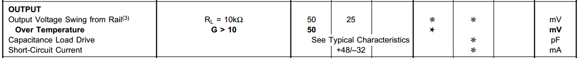

  • Leandro,
    The output voltage swing to the power supply rails on the INA331 is specified in the datasheet as 25mV typical, 50mV max with a 10k load.
    When you supply the part with 5V and Ground, the INA331 will only be able to output voltages within 25 to 50mV of either 5V or Ground. This is where the 30mV offset that you are seeing comes from. When configuring the INA331 for higher gains, the 25-50mV rail limitation is then amplified by the output amplifier A3. Therefore, if will be difficult to use this amplifier on a single supply, in high gains if you need to output 0V. Alternatively, take a look at my post here: http://e2e.ti.com/support/amplifiers/precision_amplifiers/f/14/p/296369/1034180.aspx#1034180 on the INA326 which has a differrent topology and will allow better performance on a single supply.

  • Because the internal amplifier is saturated at the negative rail, increasing the positive power supply voltage will not affect this. One option would be to add a negative power supply to the board.
