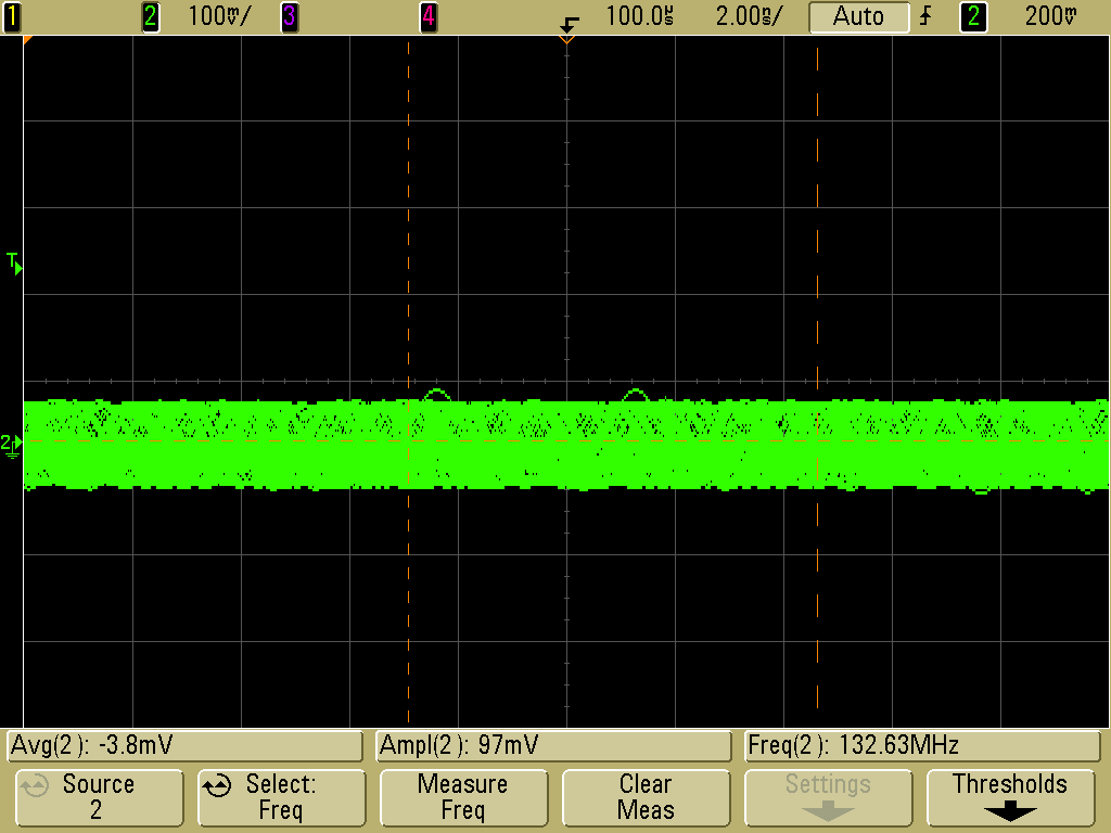

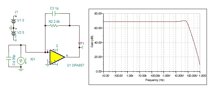

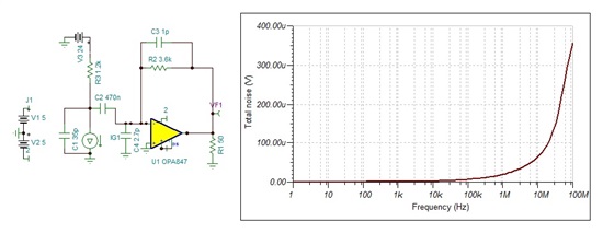

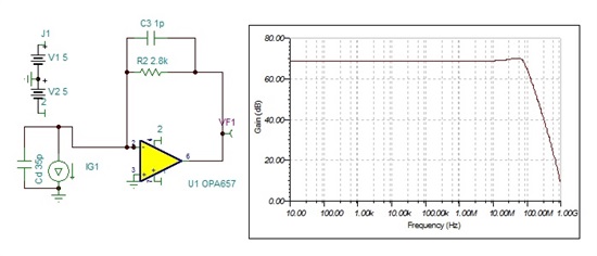

I design transimpedance Amplifier(Using OPA847) for photodiode amplifier
This circuit design on PCB surface mount but when measure it has signal oscillator and noise about 100 mV.
My oscilloscope scope is Agilent MSO6034A
Impedance load of oscilloscope is 50Ohm/14pF
And I use PIN-Photodiode Hamamutsu S6968
Please tell me what is true problem, Thank you very much
