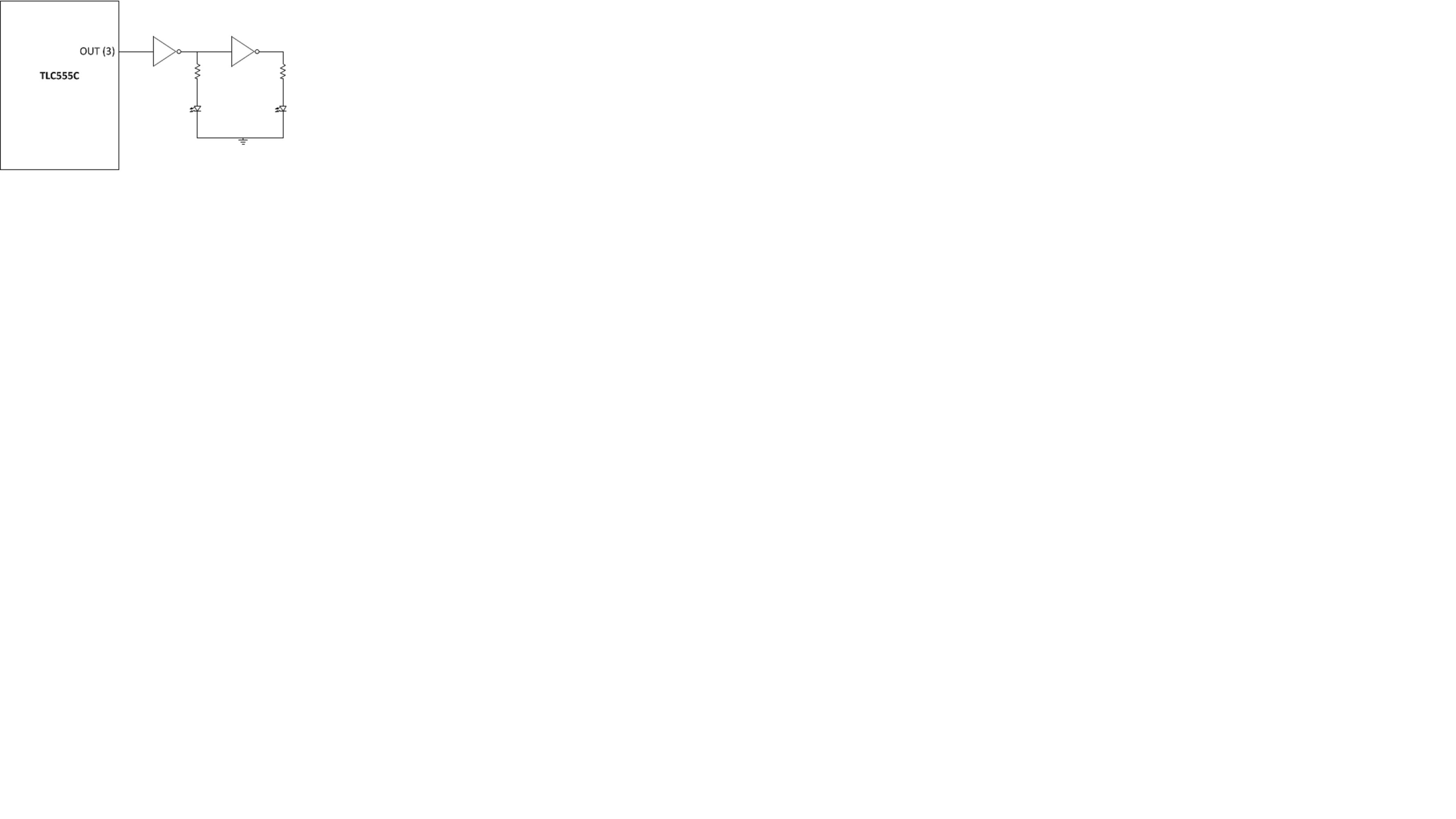

    If I decide to go with using the transistor, do you see any problems with connect a resistor and LED in series from +3V supply to output of TLC555, such that the LEDs are alternately blinking?
    Also, I might find another way to just deal with whatever source current is available with 3V.  With 3V as Vdd, how do I determine what the maximum source current the TLC555 can deliver?  The most I measured with 13Ohm load was 5mA.
  • Anthony,
    I think to get sufficient drive, you would need to use a second transistor to invert the output of T1. Alternatively, there are various CMOS inverter ICs that may be able to do all this in a single package without resistors. You would need to check carefully for drive capability at 3V supply.
    Regards,  Bruce.

  • Hi Bruce,
    I want to try to use the inverters.  It seems that inverter package will take less space.
    In looking at the following dual inverter package, SN74LVC2G04,  I see that the high level output current for Vcc=3V is -16mA and -24mA.
    I also see that the low level output current is 16 and 24 mA.
    Why are there two values for the high level and low level output currents?
    Also, I am planning to do this with the inverters and the TLC555C.  It seems that high level will be use to turn on LED, and the current should be enough...what do you think?
