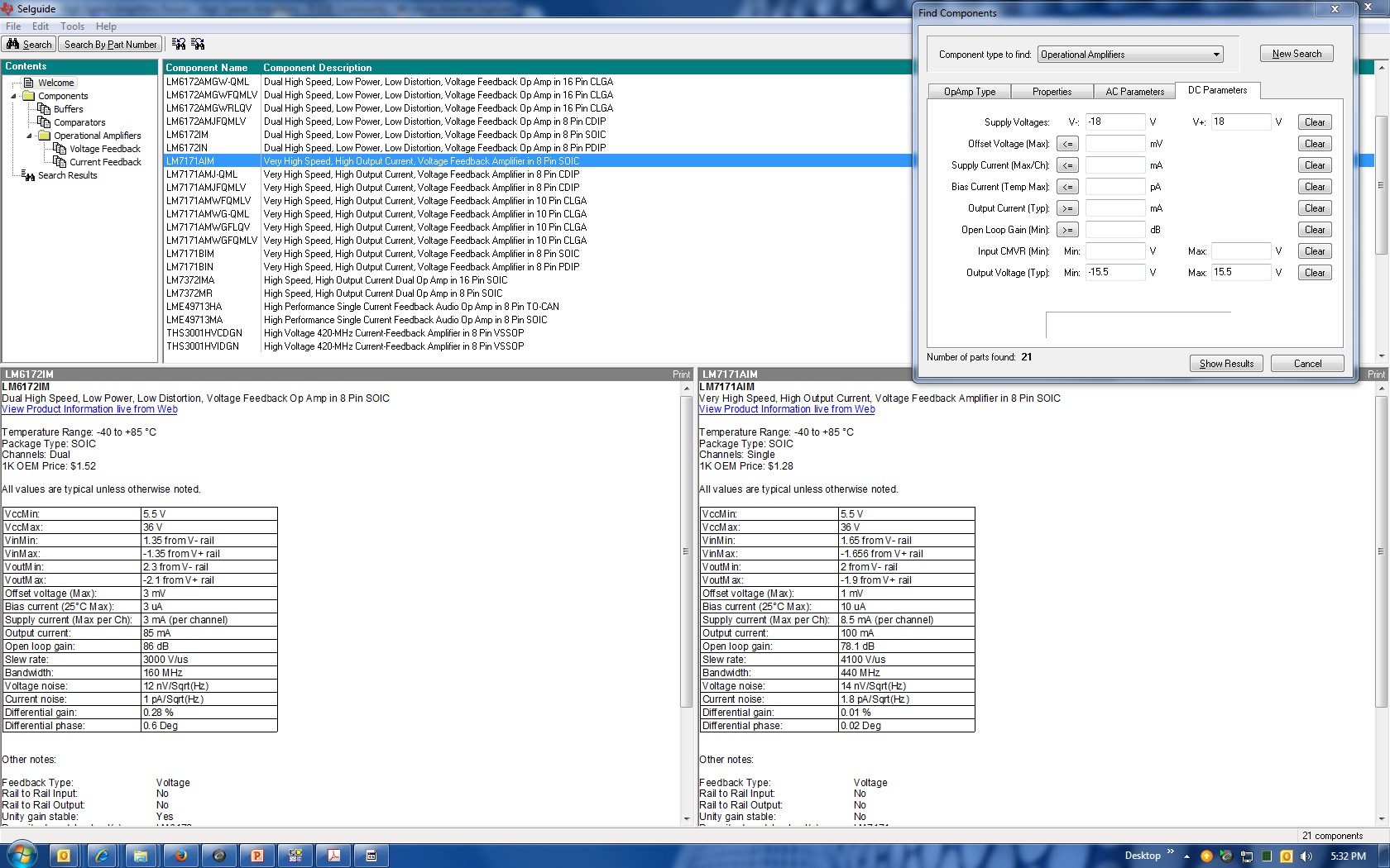

I want to find an opamp that has high speed and large signal output. I need 5MHz and 30Vpp (+15V & -15V) output voltage swing. Can I find the appropriate opamp? Thank you!
Sorry, it seems that my explanation is not enough. I have a function generator that works 5MHz & 20Vpp (+10V & -10V) by sine wave. I want to make clear sine wave of 5MHz and 30Vpp (+15V & -15V) so I need a amplifier. Is there any good opamp that you recommend? Thank you!
Here is a list of devices with at least 50MHz, 900V/us slew rate that can swing 30Vpp @ 5MHz (require supply voltages of at least +/-17), from Selguide:
http://www.ti.com/tool/opamps-selguide
LM6172, LM7171, LM7372, LME49713, THS3001
