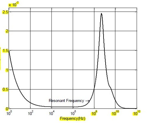

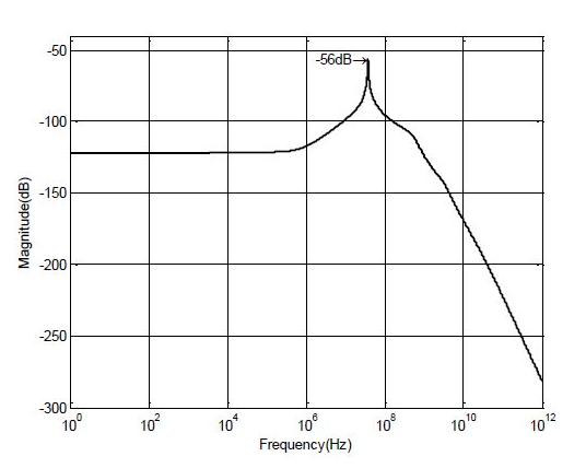

these two up side given diagram output i want get .my output is not diserable please help me choosing correct coponents values.this my design using OPA656
.1663.current sensor potodiode amplifier.TSC
please set my output.please
t
  • my required resonant frequeancy is 37.5MHZ. BANDWIDT IS 37.5MHZ.

    i am using opa656 for differential output .i want sense the phototransistor emitter current and amplify using opa656 .i want built a differential amplifier to sense phototransistor current and .
    i am working on laser Range finder triangulation method .
    i want amplify the photodiode or phototransistor current and run a servo or stepper motor to foscuse te laser beam on PHototransistor.so kindly help me
    design a differential amplifier using opa656
    regard
    EMMR

    I tried to follow your circuit and see if I can help. However, I still cannot understand many of elements. For example:
    1. Why are you using the OPA656 with 0ohm feedback resistor when your signal from the photodiode is so small (nA)?
    2. What is the purpose of R1, R2 (20kOhm) on the input? These relatively low values lower your circuit's input impedance to 10kOhm, while you've chosen a JFET input device (OPA656) which I presume was to have high input impedance? For DC biasing, you could have chosen much higher values
    3. What are the elements L1, R3, and C6 representing?
    4. Is the resonance you are speaking of on the input due to the inductor L1 and the capacitance it sees? Is this resonance something you are interested in, or is this something you are trying to get rid of? If you are trying to get rid of it, what things can be modified or moved around to achieve that?
     Sorry, I have more questions than answers. May be somebody else who can understand your question / application better can jump in here and help.
