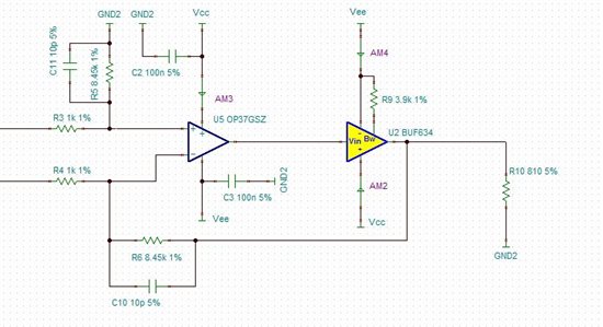

I am currently using the BUF634 in the following configuration:
Vcc=+18V & Vee=-18V.

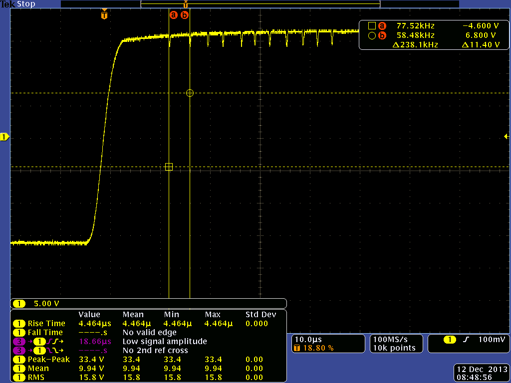

I am puzzled because when I increase the load around 20mA, the BUF634, when driven with a square waveform ±16V @ 50Hz, presents some strange spikes at around 240 KHz as depicted here below on the positive edge.
Am I using it at a limit I am not aware of?
Do you know what can cause this behaviour?
One thing for sure, when I decrease the input amplitude those spikes vanish. Moreover those spikes can be filtered by increasinf the capacitor in the feedback while reducing the bandwidth.
Regards.
