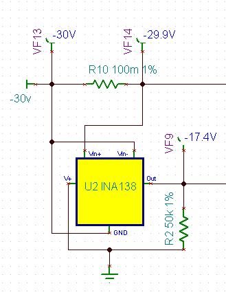

I want to measure the current across a 0.1ohm resistor on a -30V rail with INA138 and read a 100mV/A drop across the resistor. Is this the proper way to connect ? or should the V+ and GND terminals be connected in the normal way ?
From the TINA screenshot, this is not the output voltage i was expecting on the negative rail...

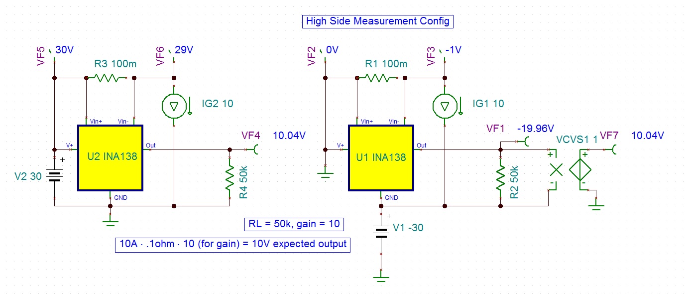

    I did a little playing around with your circuit in TINA and I expect I have a little different result from your circuit analysis, see my schematic below
    More to the point though, the INA138 is a high-side current shunt monitor and I believe this is a low-side measurement you are trying to make.  While 30V supply and common mode is within the 2.7 to 36V range, measuring on the low end is not the intended use of this device.  I did a little High Side config and found it to work but I don't know that it will suit your application since the current draw is reversed.
    I went looking through our catalog and I don't see anything that is a drop in fit for your circuit exactly as presented (mostly because of the 30V supply) but perhaps if we knew a little more about your application we could find something that will work for you.  If you could share a little more about what you're after, we will certainly do our best to assist you.
    Thanks!
    - Jason Bridgmon
  • Hi Jason
    Thank you for your reply. Unfortunately I could not see any of your attached schematic images in three different browsers, could you kindly attach them again please ?
    My application is for a dual rail power supply and yes these are for high-side shunt monitoring. What got clipped out in my schematic is the rest of the regulator etc and load on the right side of the image.

  • Soumitra,
    The second image is attached, the first one is less relevant.  I show here how to hook up the INA138 to get it to work for a high-side measurement.
    I am using the current shunt monitor selection page: http://www.ti.com/lsds/ti/amplifiers-linear/current-shunt-monitor-products.page to look for suitable CSMs for your application.
    A little more complex solution is to use an I2C output low-side CSM, powered using a Zener Diode structure between the ground and negative supply lines, and then use an I2C isolator to upconvert the voltage for the I2C bus to something manageable.  For this I would look into using a product like the INA226 http://www.ti.com/lit/ds/symlink/ina226.pdf and an I2C isolator like the ISO1540 http://www.ti.com/lit/ds/symlink/iso1540.pdf.
