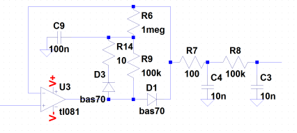

I have a circuit where I use a TL082 amplifier to drive an RC filter. At this moment, the filter is a 100n capacitor C9 with a 10R resistor R14. This may be quite a high output capacitance for the opamp. Could it cause instability in the opamp?
I have looked at the datasheet but did not find a maximum allowed output capacitance. How do I calculate which R*C combination is the minimum allowed number?
By the way, the circuit is a peak detector circuit. It is used to detect the peak of a PWM square wave signal. Supply is +/-14V.
