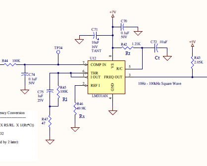

I am trying to debug 10 boards that are implementing the LM331 as a voltage to frequency converter. My desired frequency is 63 kHz. On 5 of the boards the frequency is within +/- 2kHz which is okay for my application. However on the other 5 boards the frequency is more like 78 kHz. The only difference that I have found is the voltage at Pin 5 is about 0.5V higher than ones that are in spec. The voltages at all the other pins are the same. All my resistors are 1% and the caps are 5%. I've tried changing Rt, Ct and the LM331 but the result is still the same. My schematic is shown except that Rs is now 10K and Rt is now 200 with a with a 2.6V input. Any suggestions as to why this is? Disregard the notes on the schematic. Thank You
