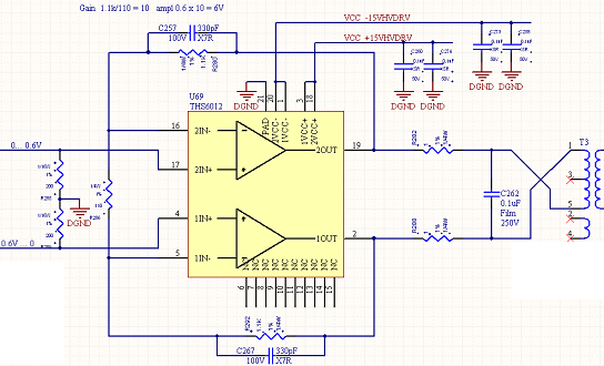

After soldering THS6012 and powering it up for first time it starts to heat immediately.  First suspect is pad - can it be connected to GND? Or left floating? I connected it to GND. Is that ok?
There nothing about it in datasheet but I seen somewhere on separate Powerpad app-note it should be grounded.  But may be for ths6012 is different....

  • Hello Loren,
    Yes, I verified by disconnecting - that  is not a pad. However what - still mystery.  Each opamp takes 90mA. Load is totally removed (one 1ohm resistor taken out). I have 3 such circuits on pcb and all they are same, so can not bee all chips equally bad. Must be something in circuit design.
    Could you drop an eye to circuit above - anything suspicious? Since there is no load I assume it should be quiescent current only (~15mA) regardless of input.
  • Hello Karne,
    I cannot read the component values in the attached schematic.
    Try disconnecting the transformer, then measure the DC voltage that is applied to the transformer primary.  If there is a DC current in the trasformer primary that could be the problem.
    Also, what is the purpose of the capacitor between the two outputs?  Excessive capacitance can cause oscillation.
