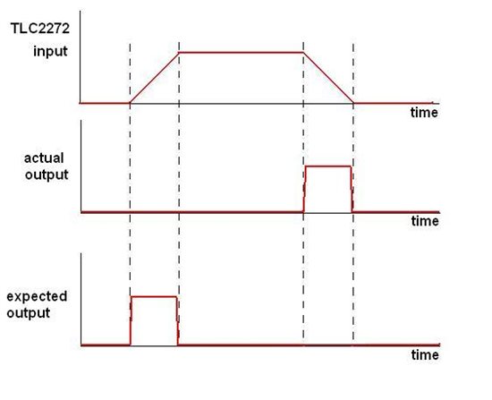

I'm having an issue with a differentiator implementation of the TLC2272 receiving an input from a LM2917.  The application is a BLDC motor halls square wave input to the LM2917, which then outputs a corresponding analog value to a differentiator to monitor acceleration.
My problem is that the expected differentiator output is reversed: An increasing input gives no response, and a decreasing input gives a positive response.  Setting my non-inverting input to 1/2 Vdd shows the increasing input gives a negative response, the opposite of what I expect.

    The TLC2272 connected as shown is an inverting differentiator that uses a single, +5 V supply. It has a voltage output:
    Vo = -R8 C6 (dVin / dt)
    There is an inversion at the output. Since the output cannot be driven below ground it stays near that level when a positive dVin /dt occurs. It moves positive when dVin /dt is negative. That coincides with the result you are obtaining.

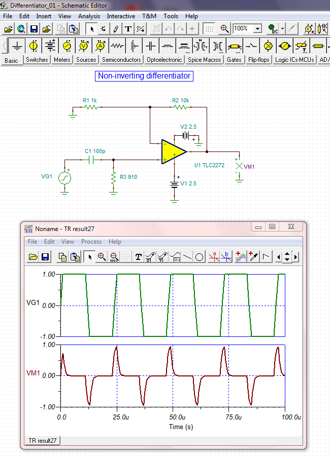

  • Hi Giuliano,
    There are several topologies for a simple, non-inverting differentiator. They reduce to a non-inverting amplifier with a gain of RF/RS at higher frequencies where the capacitive reactance is very small. A non-inverting differentiator that I've evaluated is very similar to the circuit you had drawn. Its circuit is seen below. The R and C values have been picked such that a 41.7 kHz square-wave, having a 1 V/us edge rate, results in the positive and negative going "blips" associated with a differentiator. Note that the blips have the same polarity as the input waveform edges.
    The R and C values could be selected to differentiate the input waveform as needed. A dual polarity supply is necessary if the output must swing below ground.
    I have attached the TINA Spice circuit simulation file should you want to try simulating it.
    Regards, Thomas
    PA - Linear Applications Engineering
